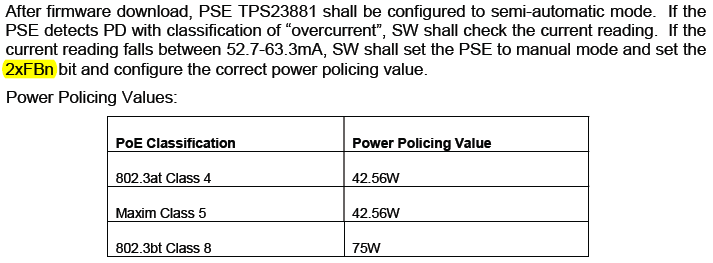

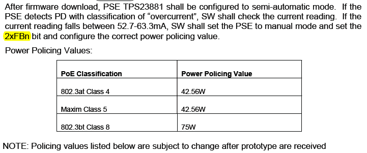

2. customer's design target:

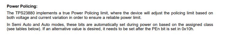

  • Hi Oliver,
    The PCUT value will be set at turn on by PSE device based on assigned class level. Since your PD is class 8, PSE would set the PCUT to 90W based on IEEE standard. If you want to set the PCUT to a different value, you will need to adjust PCUT after power enable bit is set in 0x10. Thanks.

    Customer has tried the method you have provided, it can work for. The power policing is right for 803.3at class 4 and 802.3bt Class 8.
    But for Maxim Class 5 mode (which is listed  in above table), the output is normal, but power policing is not right, the port would not shut down correctly. Dose Maxim Class 5 mode needs a special configuration?
    Below is customer's configuration, the PD would not cut off even the power is higher than 50W. Could you give some suggestions?

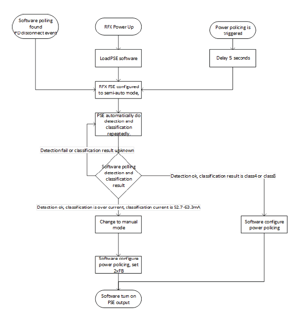

    Customer's configuration:
    A. when port current falls between 52.7~63.3mA,  it would recognized as Max Class 5
    B. Power
      ret = tps_SetDevice4PPowerAllocation(addr1,_4P_45W,_4P_45W);
    C. set the diagnostic mode:
                        ret = tps_SetDeviceOperatingMode (addr1, OPERATING_MODE_DIAGNOSTIC, OPERATING_MODE_DIAGNOSTIC,    OPERATING_MODE_OFF, OPERATING_MODE_OFF);
    D. Set the foldback mode:
                        ret = tps_SetPortILIM(s_sysChanNum, _2X_ILIM_FOLDBACK_CURVE);
    E. powering the channel:
                        ret = tps_SetPortPower_4P(s_sysChanNum, TPS_ON);
    F. Cycle detection of PowerEnable status,if it's enabled, set the power policing to 42.5W
                        CurPseParm.powerPolic = 85;                       //42.5W * 2
                            tps_GetDevicePowerEnableStatus(addr1, &powerStatPEnabn);
                            powerStatPEnabn = powerStatPEnabn & (PE1_STATUS + PE2_STATUS);
                            if(0 != powerStatPEnabn)                          //Power on (0x33)
                                osDelay(100);
                                ret = tps_SetPort4PPolicing(s_sysChanNum, (uint8_t)(CurPseParm.powerPolic));

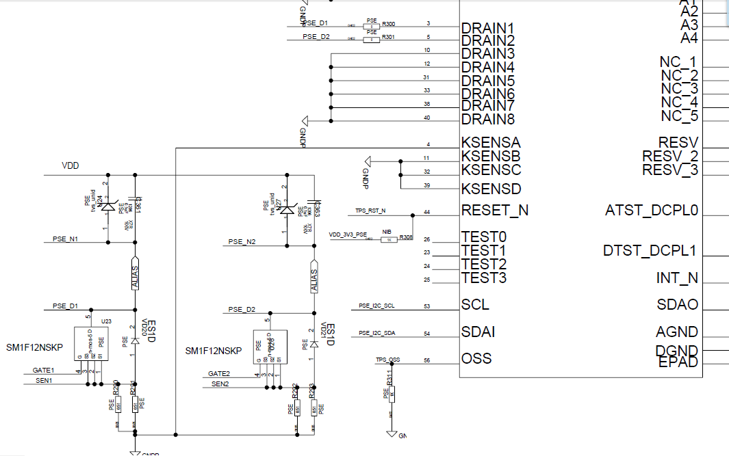

    In your code, you configure the ports to 4 pair ports, so I assume the hardware is design that way.If your hardware is designed in the way that the port is 4 pair port, you have to set the 4P PCUT. Can you share your schematic? Thanks.
    Penny
  • The schematic:
