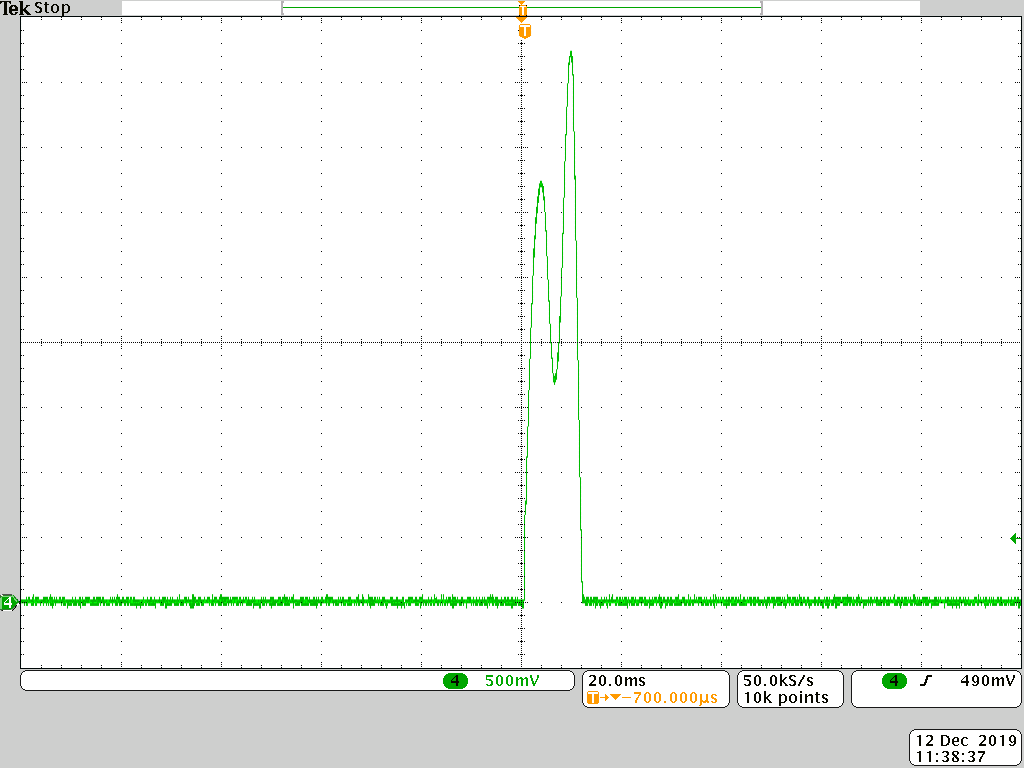

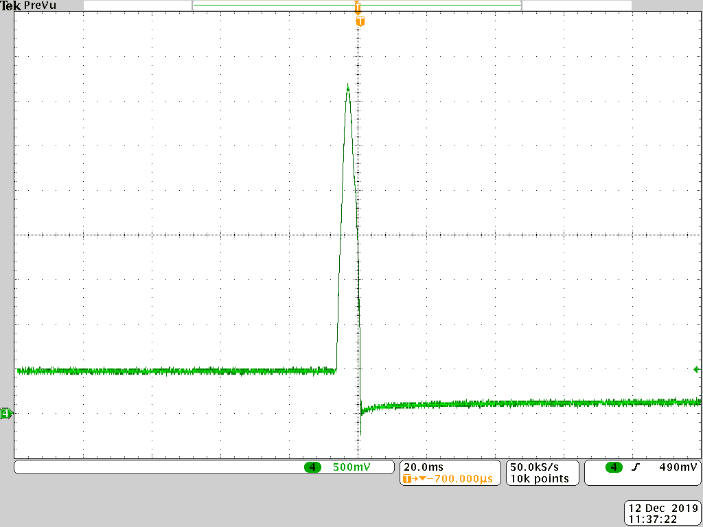

Hello, I Have some startup problem with UCD and PTD08A10WAD, I have 3 identicaly assembled boards, on one of them the power rails starts with a correct ramp.
ON the 2 others boards, I can't regulated at startup with the same parameters (I copy the EEPROM of the good one). the rail do a Strange startup wtih overshoot to more than 3 times the voltage value and do I lots of oscilation at 100Hz before stabilsed to the consign voltage value.
Could you help me, Do you have some notes about this, do you think the USD are HS.
thank you
