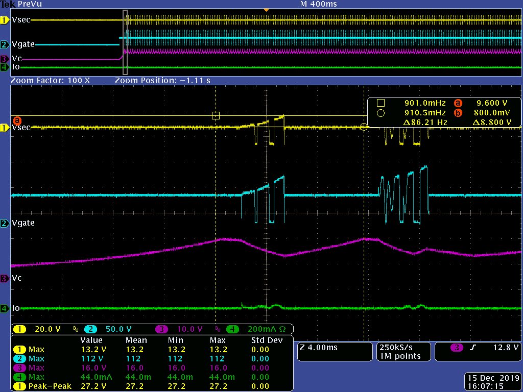

Hi All,
As I know, Vc cap is charged by TPS23754 internal LDO. When it charge to 15V, internal LDO will turn off, the Vc cap stored power start up to gate signal and switch the MOSFET. When the MOSFET is switching, the transformer will generate voltage to charge the Vc cap.But when Vc cap is too small, the stored power from capacitor couldn't drive the MOSFET for three duty cycle and couldn't generate voltage to charge the Vc capacitor and Vc voltage will run to UVLO. Like image below.
 When I enlarge the capacitor value, then issue could be fixed. But original capacitor value I used is 22uF. The stored power will "Q=CV=22uF*15*0.5=165uC"
The MOSFET's Qg I used is 9nC. Normally the stored power could drive the MOSFET completely, but the result is wrong. Is IC has another function will use the power the Vc cap stored?
Roy
  • Vgate means MOSFET "Vds"
    Vsec means 12V that transformer generate to charge Vc cap
  • Hello Roy,
    Thank you for your question. The VC pin is also internally connected to Vb through a regulator. Increasing the VC cap is a typical design debug step, so it is not surprising. I would also suggest including a 1uF cap in parallel to bypass the gate drive if it is not already present.

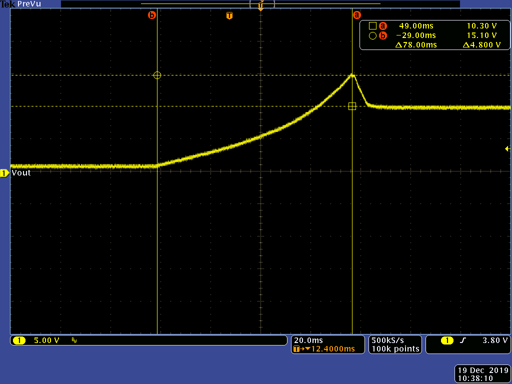

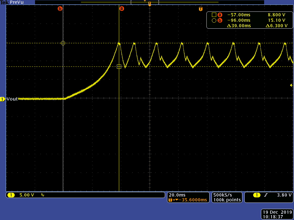

  • Hi Michael,
    This specification is Vc from 0V-15V. I also measure the customer board VC waveform below. When I use 22uF. The bootstrap start-up time is only 39ms and it doesn't meet the specification and it's non-linear. Because VC is charged by constant current and why it charge quickly to 15V and non-linear?
    And I also add the Vc cap from 22uF to 44uF to charge more energy. and its start up time is 78ms. VC could normally work. do you have any idea about why  Vc waveform is non-linear because I also measure the EVM420 board VC waveform and shows linear
    EVM board meausement, 22uF;81.4ms charge times
    Thank you for your help.
  • Hi Michael,
    I find the issue. The VC capacitor we use is MLCC material, the capacitor value might be changed when voltage get high, so the charge curve is non-linear and let stored energy get lower and I change the cap from MLCC to EVM board'cap. It could normally work and meet the specification. Thank you for your help.
