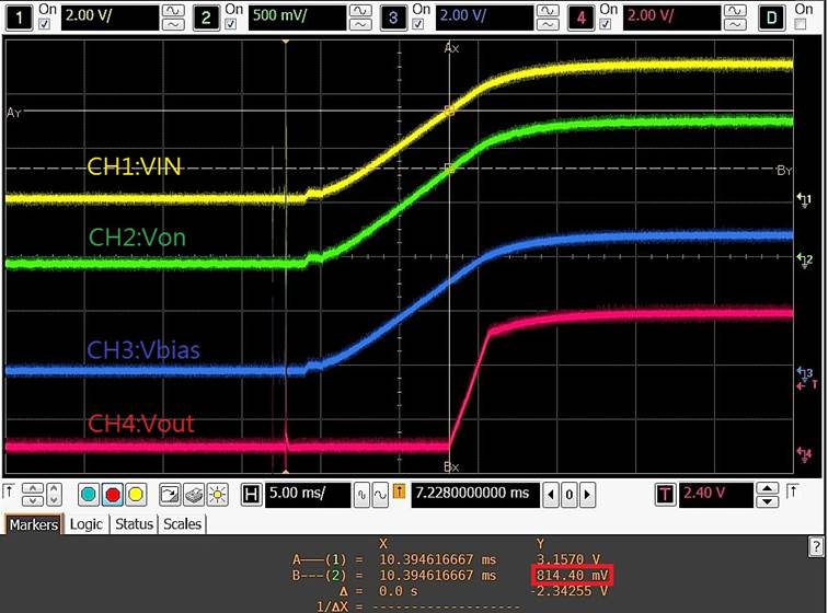

Hi Team,
My customer is evaluating EVM board and found turn on threshold is about 0.8V not like datasheet showed the VIH is 1.05V(TA< 85°C). The customer test condition as following.
Customer added a divided resistors on ON pin in EVM and the purpose is to tune on TPS22975 when VIN arrive 4.5V.
Both VIN and Vbias are connected to 5V supplier, thee Von pin divided resistors are 12K and 4.3K and one terminal of upper resistors(12K) is connected to 5V supplier. When 5V supplier raises and the ON pin voltage closes to 0.8V, TPS22975 turns on.
Vin and Vbias are powered from 5V supplier first, then increasing ON pin voltage slowly and when it achieve 0.8V then TPS22975 was turned on.
Could team help to comment on this case.
