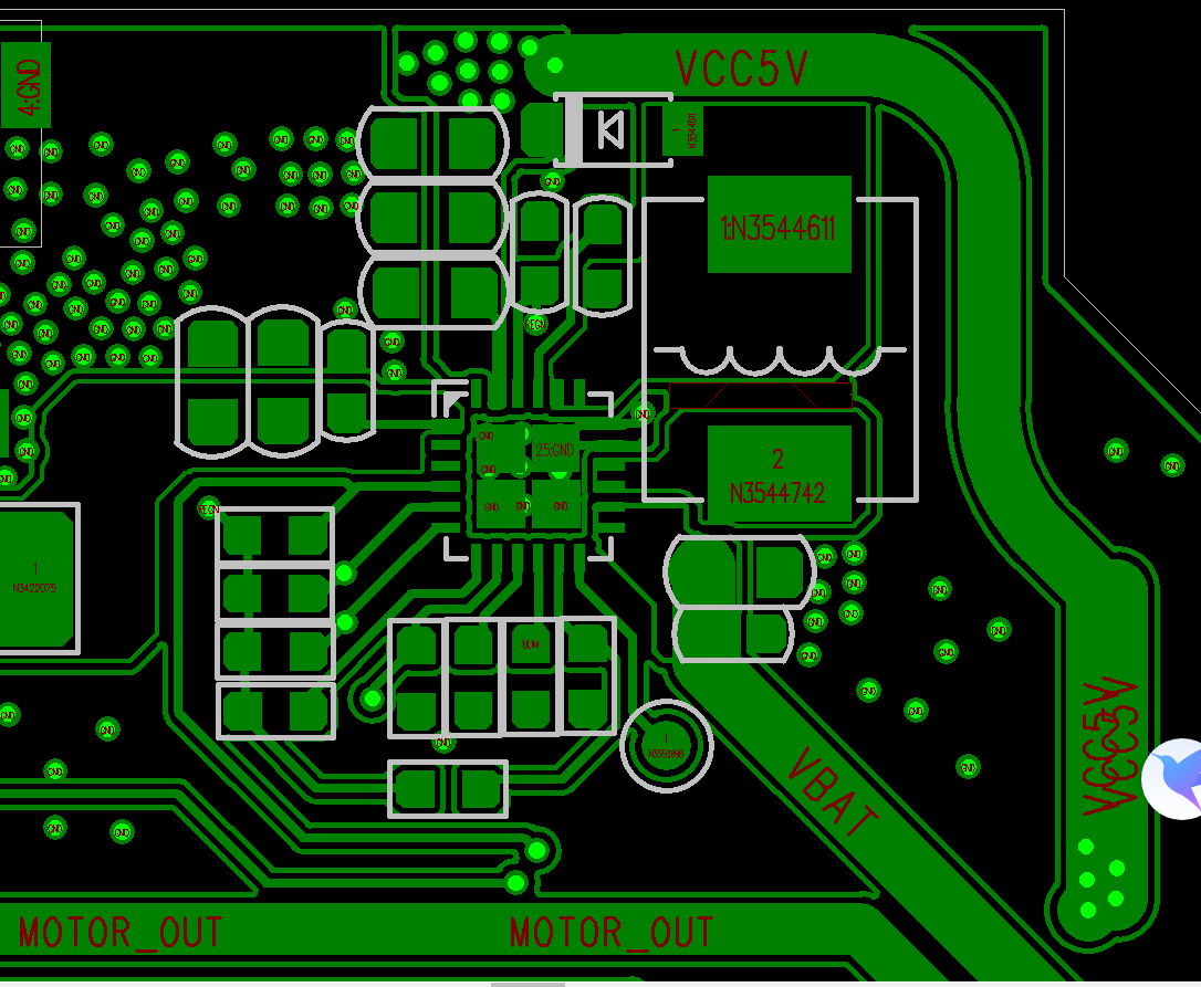

We design with BQ25895, use non-standard adapter as input, one output charge the battery, another output to OTG to power the peripherals.
When there is no adapter, the battery power is boosted to OTG to power the peripherals at the same time, such as the schematic diagram of the accessory and the pcb diagram. In the current debugging, the maximum input current limit is set to 3.25A.
ILIM  pin connect to 100ohm, the constant current charging current is set to 2A. D + D- Detection function is disabled. Register settings are as follows:

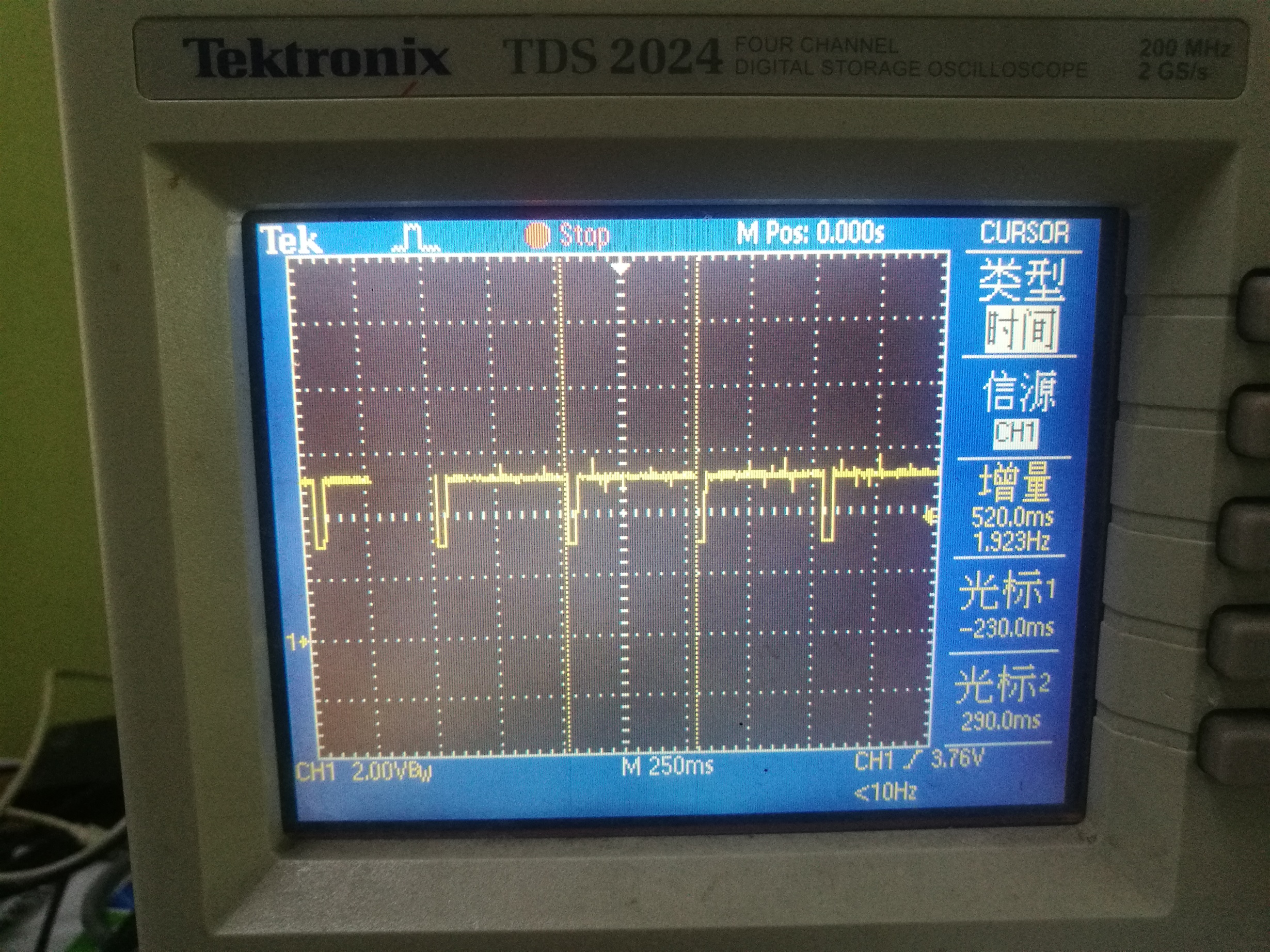

3. Only connect battery, OTG output is connected to 3A load, OTG output voltage is 4.9V. Attached OTG waveform as below.
7536.bq25895.pdf
OTG  waveform

  • Hi Star,
    Regarding 1, I assume you are expecting higher charge current?  If so, what is the voltage measured at VBUS and VBAT pins?  What do the status registers report when charging?
    Regarding 2, I don't understand the statement "plug in the adapter" in OTG mode.  In OTG mode, you cannot have an adapter at VBUS.  If there is an adapter at VBUS, OTG mode is disabled, charge mode is enabled and any load at PMID load gets V(PMID)=V(VBUS)-RBFET*IPMID
    Regarding 3, the waveform shows the OTG output collapsing every 500ms.  Can you retake showing the IOTG current and the SW node?
    Jeff

    The VBAT voltage is 4.2v. 5v input voltage
    The sw switching waveform is as follows. In addition, we set the switching frequency to 1.5MHZ, why the test only 500Khz.

  • Star,
    If OTG_CONFIG bit =1, any write to the boost switching frequency bit is ignored.  You have to write to the boost switching frequency bit before enabling OTG boost mode.  Were you able to measure the load current on VBUS during OTG boost mode?  Were you able to capture the status and fault registers?
    Jeff
