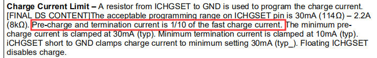

After I was test the bq25886-EVM.I meet some questions.
FIrst,When I set the ICHGSET to 1.3A,it should be 130ma compared to ITERM according to the datasheet.
But the actual test is when IBAT = 20ma, the charging is terminated.Why?

    1. ITERM can be tricky to measure correctly. Describe to me how you are accomplishing this and if possible provide a diagram of the setup.

    1.I use tp5 and tp6 to measure the voltage of R6,then I know the IBAT. From the datasheet, we can know the value of iterm.

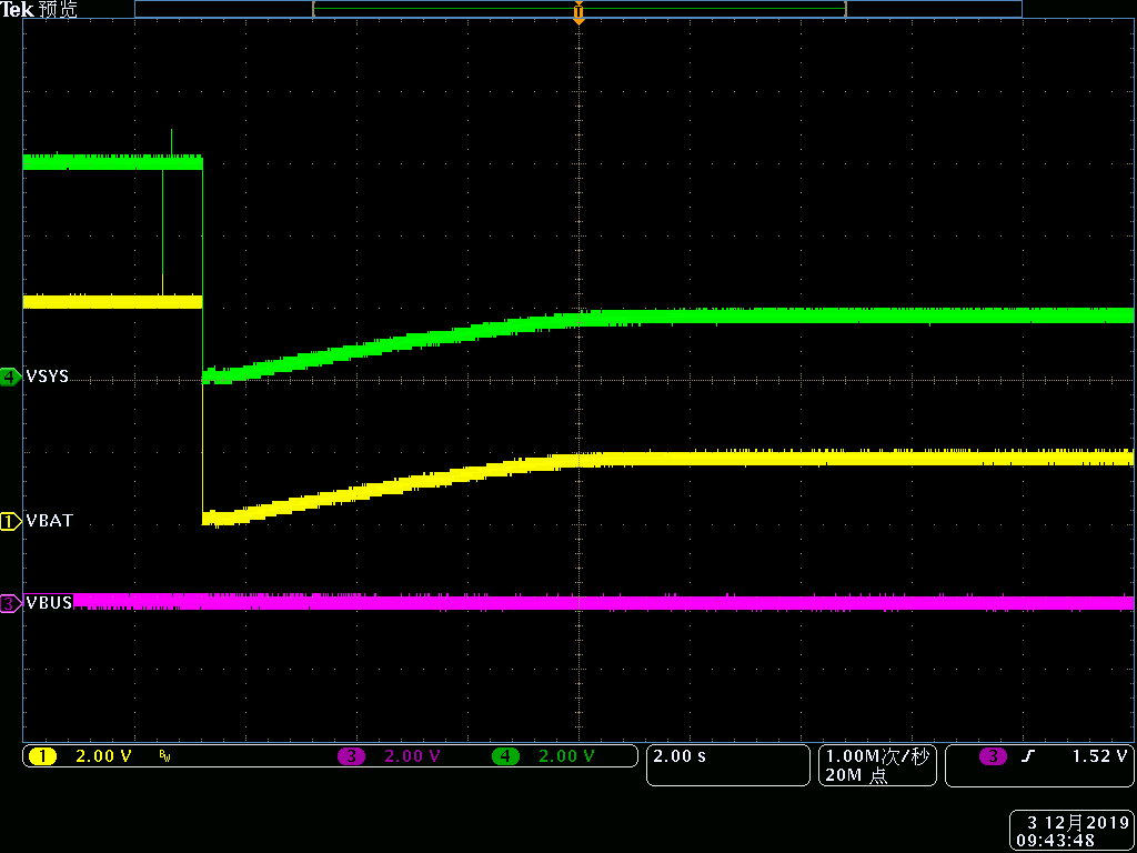

    6.When I short-circuit vsys for a while, why does the voltage on vsys and Vbat change from 0V to 1.65V.(I'm not connected to VBUS)

    1. How quickly are you sweeping the battery voltage when measuring ITERM? If you sweep too quickly the ITERM comparator will trip at 130 mA but due to the reaction time termination may occur a little bit later.
    2. Could you please provide a scope capture of this please showing VBUS, IVBUS, VBAT, and IBAT?

    6. This occurs because when operating only from a battery the system is connected directly to the battery via the BATFET body diode. If you short the system to GND you short the battery to ground as well.
