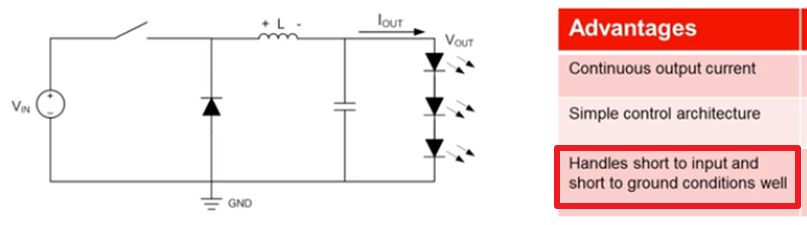

Hi team,
What's the meaning of "Handle short to input and short to ground conditions well"?
Hi team,
Hi Naizeng,
For example, for buck converter, when the output short to ground is happen, the high side FET can be closed to limit the current.
