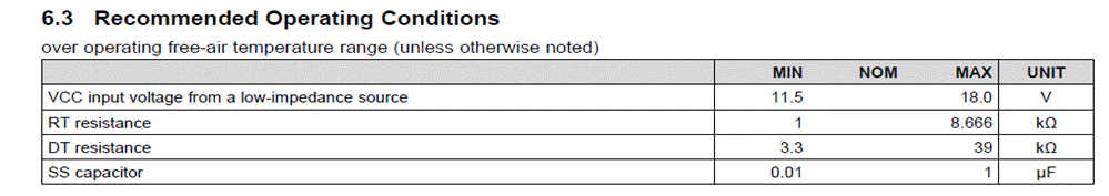

I would like to know why the Recommend value of the Min value of R1 is 1 kohm.
What is the concern when using RT resistance under 1kohm?
Thanks.

RT sets the switching frequency and lower values result in higher frequency. However, the RT pin has an absolute maximum rating of 5mA (see section 6.1, page 4 of the datasheet). I believe the recommended lower limit of 1K is intended to keep a comfortable margin from the Abs-Max current out of that pin.
Also, based on Eqn 2 (page 11) the fixed term of 150ns in the denominator means that reducing resistance results in non-linear diminishing increases in frequency, so it would require a larger drop in RT value to achieve a significant increase in frequency, and that pushes the current close to the Abs-Max rating.
