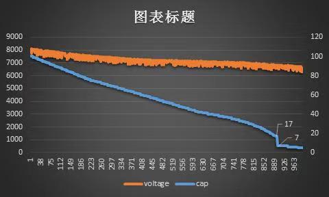

Hi, my customer is using BQ4050 for 2 series battery pack gauging, the capacity jumps from 17% to 7%.
The load doesn't increase or decrease apparently, shown below:
what may cause such jump?
what information we need to provide to find the cause of this jump?

    Have you configured the CEDV parameters for the gauge? This is necessary for gauging accuracy. When the SOC drops to 7% it means that the EDV2 voltage has been reached. Please see the online GPCCEDV tool for more information on this process: http://www.ti.com/tool/GPCCEDV

  • Matt,
    we have configured the CEDV parameters for the gauge.
    I have several questions:
    1. If we use CEDV instead of EDV, let's say we have already programmed the gauge with the seven CEDV parameters.
    The EDV0, EDV1 and EDV2 are calculated by the gauge during the one discharge process, it's not a fixed value, right?
    For example, the end equipment is a ePOS. We discharge the battery at 1C from 100% SOC to 50% SOC, the EDV2 which corresponds to 7% SOC may be calculated to be N1 voltage, then if we start to discharge the battery at 0.5C from 50%, the EDV2 calculated may be N2 voltage, right? The exact voltage corresponding to 7% SOC, 3% SOC and 0% SOC is always changing during one discharge cycle, right?

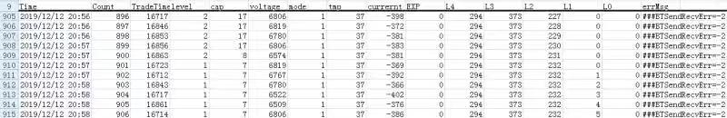

    2. I see that the capacity jumps from 17% to 8% along with the voltage jumps from 6.806 to 6.574V in the picture I posted in the thread. Is it true that CEDV gauge is not suitable for application where the battery voltage will jump? Since CEDV gauge will use battery voltage to estimate SOC, if battery voltage jumps, SOC will jump, right? Will impedance tracking device behave better in such cases?
    3. Is it true that if we can keep the battery voltage decrease smoothly, the reported SOC will be smoothly decreasing instead of suddenly jump?
  • Hi Howard,
    Matt is on vacation this week, so his response will be delayed.  I have not worked with this device in detail, but I can try to offer a few comments based on my understanding.
    While in CEDV mode, the EDV0/1/2 levels are generally recalculated regularly during operation, I believe this is every 1-sec.  If you have a log file of a discharge and note the EDV levels reported, you should see them changing as the load and temperature change.
    However, the EDV voltage recalculations can be overridden, with them forced to stay fixed, depending on settings within the device.  The [FIXED_EDV0] bit forces the EDV0 voltage to not be modified, and the [EDV_CMP] bit can disable all dynamic calculations for the EDV voltages, even if in CEDV mode.
    The jump that occurs at 7% is correcting errors that have accumulated earlier in the discharge.  While it appears the capacity slowly reduced to 17% before the jump, actually the capacity had really been slowly reducing to ~7%.  The device corrects the error when it reaches EDV2.  Have you completed a learning cycle on the battery?  If not, then it is not unexpected to have a jump, since your Full Charge Capacity is probably incorrect, it needs the learning cycle to learn the capacity of this specific pack.
    You can also use the CEDV Smoothing feature, which rather than the SOC dropping immediately to 7%, it smoothly ramps the SOC downward as it nears this voltage.
    CEDV gauging can be used in systems which incur voltage jumps, you may just need to tune the smoothing feature for your specific case.  Per your question #3, even if the voltage was decreasing very slowly and smoothly, if the gauge reaches EDV2 and the reported SOC is above the 7%, it will still need to correct the error, either through a jump or a smoothed transition.

  • Terry,
    thank you very much.
    Now we have almost find the cause of the jump.
    When the POS is in sleep mode. The POS itself will consume 100uA, and BQ4050 will consume about 200uA measured. (BQ4050 in SLEEP mode, CHG off, DSG on, no SBS communication). The total current consumption is about 300uA.
    The battery design capacity is 2300mAh.
    They have put the POS in sleep mode for more than 10 days so it causes the capacity jump. And the discharge current is so small that's beyond the Coulomb counter's resolution. The actual capacity has decreased a lot (for instance from 70% to 60%), but the gauge still think it's 70%. And this error is corrected at 7% point.
