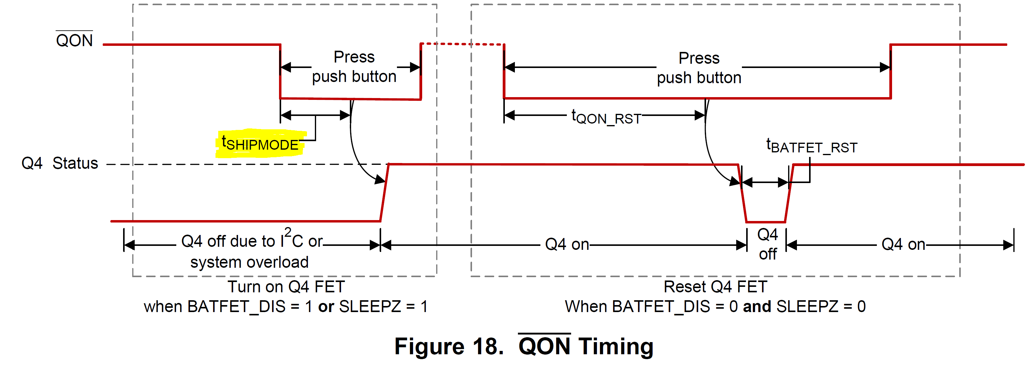

BQ25601: Electronic control of QONn pin: How long is tshipmode?
Part Number: BQ25601
My application uses the QONn  pin as an input to get the BQ25601 out of shipping mode.
The QONn pin is controlled by a sensor that is connected directly to the battery.
Q1) How long is tshipmode? I cannot find it in the datasheet.
Q2) If the sensor output remains low for a long period of time, will the reset of BATFET still occur if the BATFET_RST_EN bit is set to zero?
Thanks in advance for your answer!
