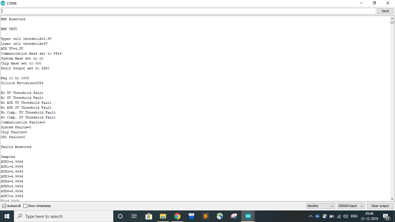

BQ76PL455A-Q1: Error in Unlatching fault bit of 0x0e register
Part Number: BQ76PL455A-Q1
Other Parts Discussed in Thread: BQ76PL455A
When I'm using 0x0e register for using the unlatching fault output then the communication between my microcontroller and the ic bq76pl455a stops and it only starts when I unplug all the voltages or if I reset the BMS with 0x52 register. Please do suggest some method to get my fault as an unlatched one
