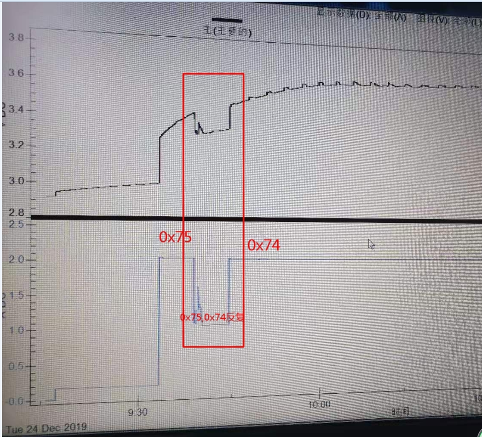

BQ25601, high-current charging 2A setting, rechargeable battery capacity 19000mAH;
An abnormal phenomenon was found during charging, as shown in the figure below. At the beginning of charging, the charging current would decrease to 1A after rising to 2A for a period of time (11:50-11:55), and then resumed to 2A after a period of time.

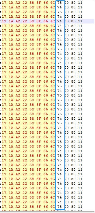

    Today, a program was changed to output the value of the register, and it was found that there was a current from 2a->, 1a->, 2A process to summarize the value of REG08 into three stages:
    1, the prophase is 0x75;
    The middle of the 2 is 0x75, and 0x74 repeats for about 5 minutes.(as shown in the screenshot on the left)
    3 the anaphase is 0x74;
    4 the left log screenshot is the value of reg00-reg0b, and the right screenshot is the battery charging curve.
    Please help to analyze the situation and remind us of the matters needing attention in use.
  • Chen,
    Based on the REG08 map, it looks like the device is going into VSYSMIN regulation when the charging current drops. This occurs when the device is trying to maintain the minimum system voltage on the SYS node and the battery is less than VSYSMIN. Is this an actual battery being charged or are you simulating a battery with bench equipment?
