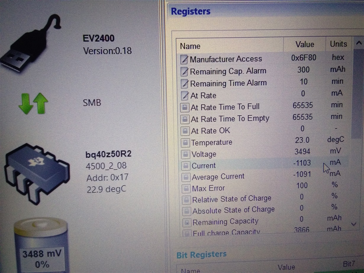

BQ40Z50-R2: Current (mA) data from fuel gauge (BQ40Z5O-R2)
Part Number: BQ40Z50-R2

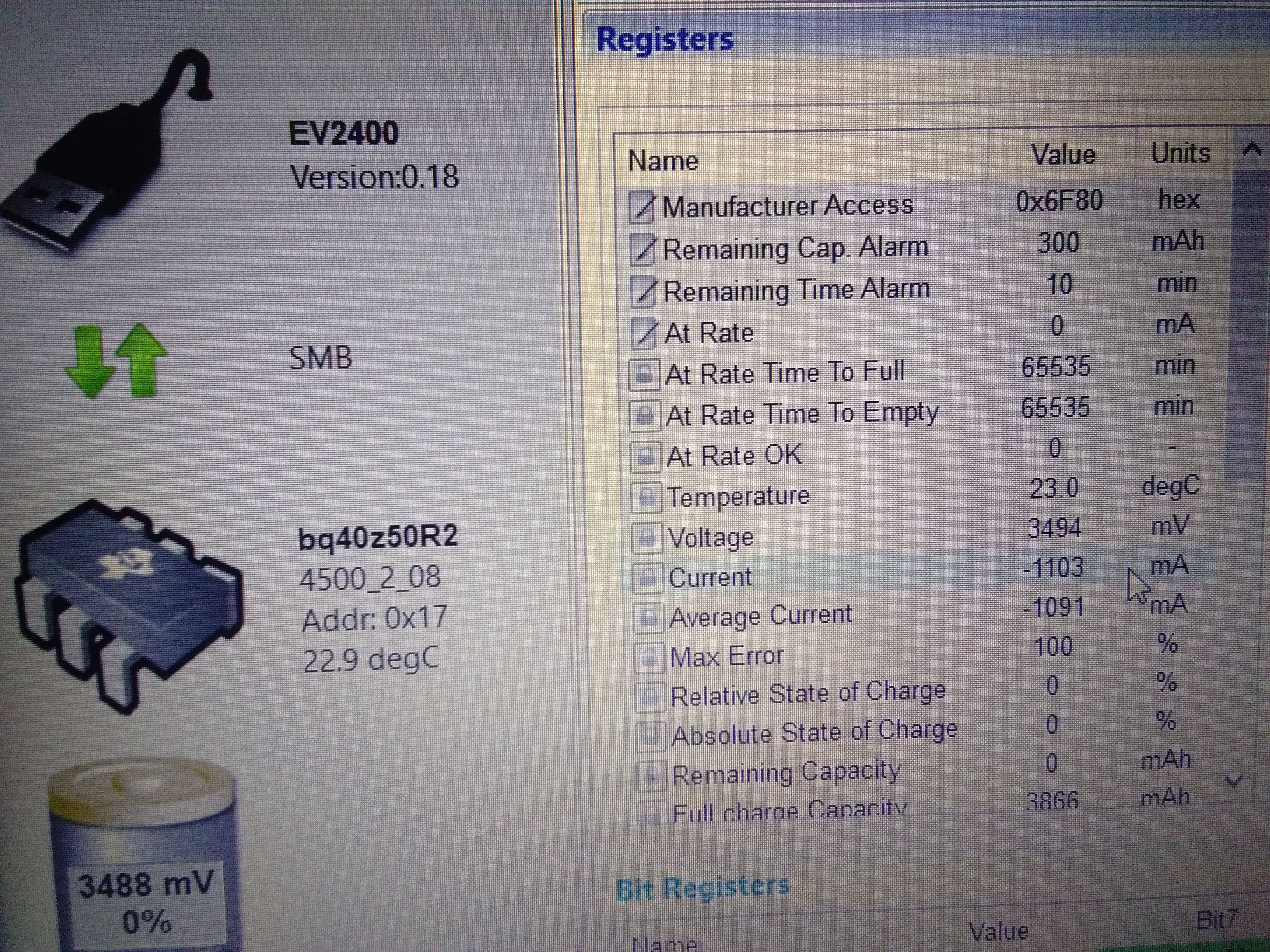

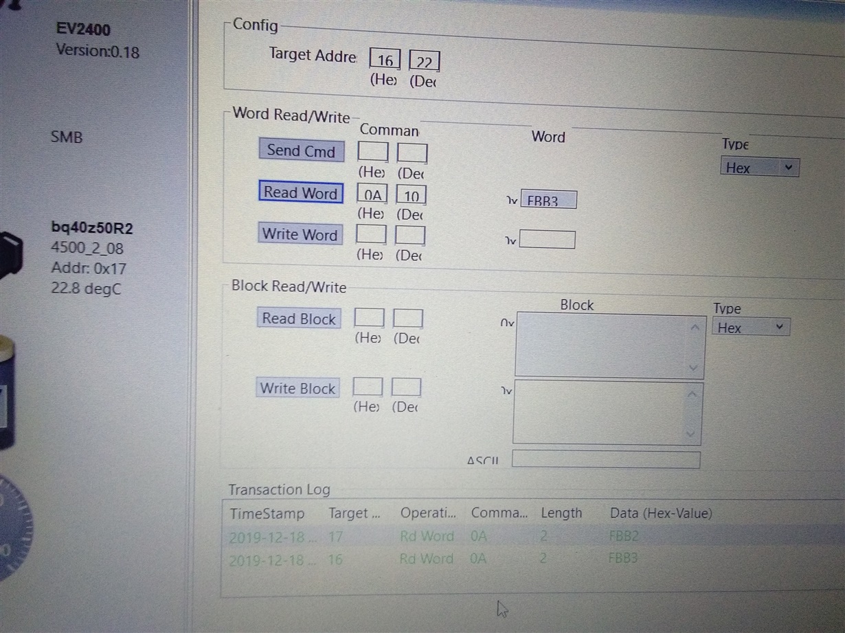

I am trying to get data of battery in stm32cubeIDE,I have taken voltage and temperature of battery successfully but when i was trying to get current of battery, it shows value like 65535 or 65473....like a garbage value.I am reading current in milli ampere.I also checked value on bqstudio as shown below image and it is (-1103mA),negative sign because it is discharging current,i think so.
But when i send the register address of current in this same bqstudio,it shows garbage value FBB2 i.e.64434 same as showing in stm32cubeIDE. I have connected load of 5ohm and battery voltage is 3.5v .Please give me any suggestion.
