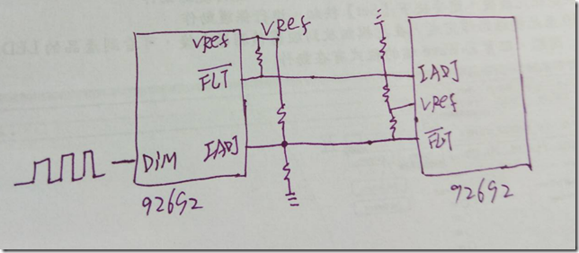

Dear Sir/Ms.
The customer designed 2 92692 ICs, and if any one is abnormal, the other one must be turned off !! (failure interlock)
But one of them will always have a PWM signal input. I wanted to use DIM PIN to interlock but there was no way.
Whether it can be achieved in the following way.
If the customer wants to implement One-Fails--All-Fail, any suggestions?
