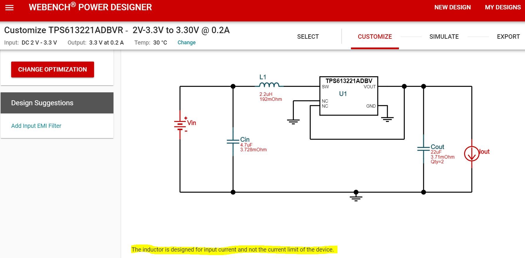

I need your expert advice regarding for current limit of device TPS613221a. I have used Webench design (power designer) to see the recommended components and design for my application using TPS613221a. According to the design there is a statement that "the inductor is designed for input current and not the current limit of the device".
My problem is I am using TP613221a boost converter in my project however our device does not start and it seems that boost converter is not able to deliver such a high current. The load current of our device can go in to hundreds of mA. Could you please advise a solution for this issue. Basically, I would need help to design the circuit of boost converter that would reach the maximum current limit of the device. According to the datasheet TPS613221a has a max peak switch current limit of 1.6A.
