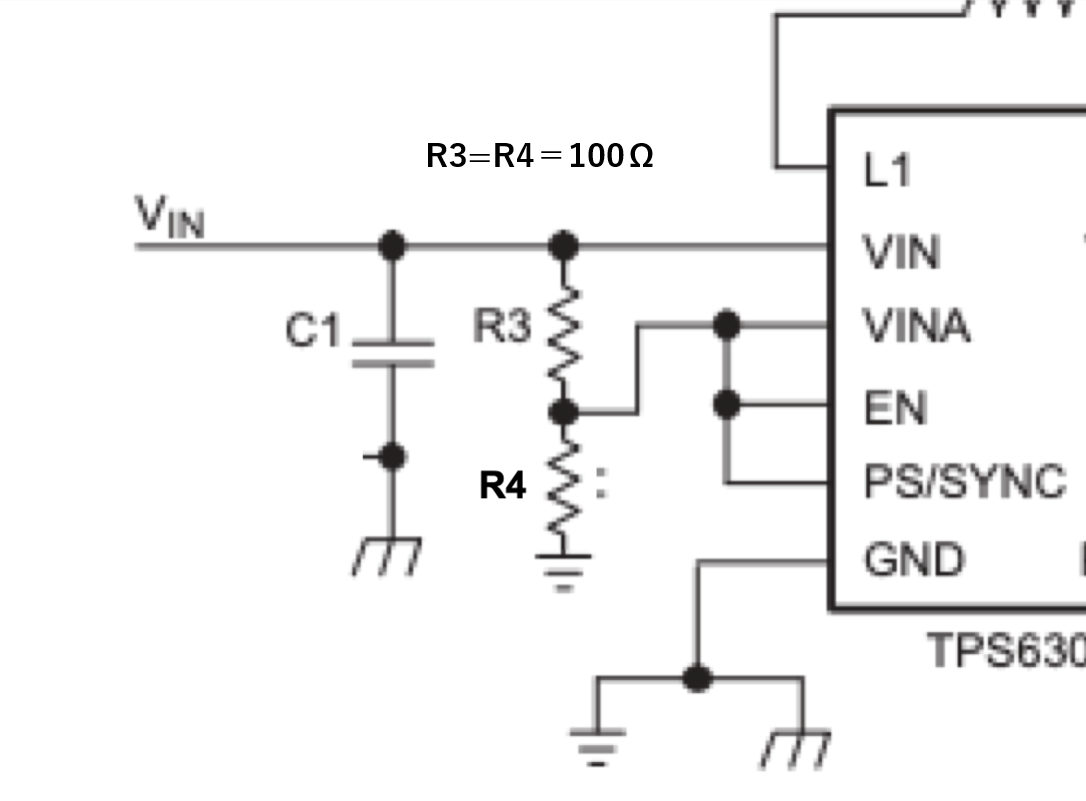

  • Hi Miniqiu

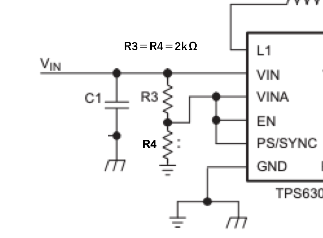

    My customer is trying to output Vout = 5V / Iout = 500mA at Vin = 4 ~ 5.5V with this device.
    In addition, they are trying to enable the IC at Vin = 3.6 V at startup by placing a voltage divider resistor as in the following circuit
    (Because the threshold of UVLO of VINA is max1.8V)
    * Connect a 0.1μF capacitor before VINA.
    When the following circuit starts up, VINA current consumption causes a voltage drop in the voltage divider resistor, which causes the voltage on the VINA pin to drop, and there is concern that UVLO will be applied after startup.
    Also, customers have asked us how much the voltage divider resistor is recommended.
    I would like to tell you about the current consumption of VINA.
    If there is a recommended value of the voltage divider, please let me know.
    Y.Ottey

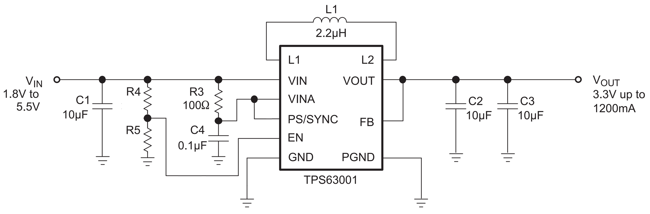

  • Hi Y.Ottey,
    The correct way to do what you want is like this:
    R3/C4 make a filter for VINA, and R3 should not be larger than 100 Ω. You should set the input voltage threshold with a separate voltage divider R4/R5.
    However, as discussed in your previous thread, EN threshold of the TPS6300x is not precise and cannot be used for defining a precise Vin level to turn the device on. The threshold is not 1.2 V, but anywhere between 0.4 V and 1.2 V.
    Please use an additional voltage supervisor circuit, or another device with a precise EN threshold, such as TPS63802.
    Milos
  • Dear Moniq, Milos,
    Thank you for your reply.
    For example, if the device is activated in the following circuit, it is considered that the voltage drop at R3 causes a difference between the voltage at the VIN pin and the voltage at the VINA pin.
    If there is a voltage difference between the VIN pin and the VINA pin, is there any abnormality in operation?
    Also, is there a tolerance for the voltage difference between the VIN pin and the VINA pin?
    Y.Ottey
  • Hi Y.Ottey,
    We did not characterize the device for voltage difference between VIN and VINA. VINA is the supply for the internal control circuit, and must be at the same voltage as VIN.
    Milos
