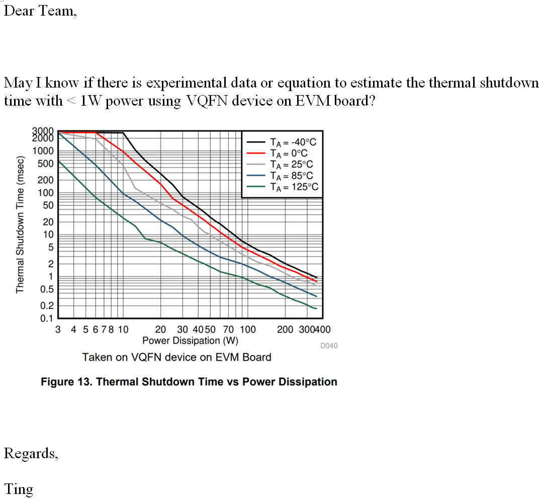

Part Number: TPS1663
Hello Ting,
The data used for Fig13 was captured on EVM board with VQFN package. This data is available in Thermal Shutdown Limit plot in TPS2663 Design Calculator (Rev. B). But the data is only available for power dissipation > 3W
