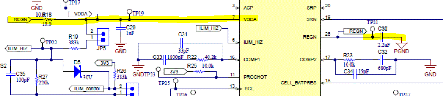

bq25713b regn pin no-output in my design
input voltage of vbus is  11v , regn pin place 3uf cap
11v  convert  3.3v by external ldo ,  3.3v connect to vdda
voltage of ilim_hiz is 1.6v
voltage of vsys is 0v
input voltage of regn ldo  from vbus, but  regn ldo no output
i need your help
thank you

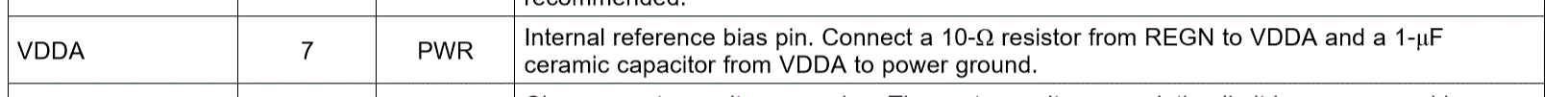

  • Hi There,
         Thanks for asking. Actually VDDA should not be powered externally, instead below is the correct VDDA pin configuration and TI EVM schematic is also added. Vsys=0 because controller still shuts down due to low VDDA voltage external clamp.
