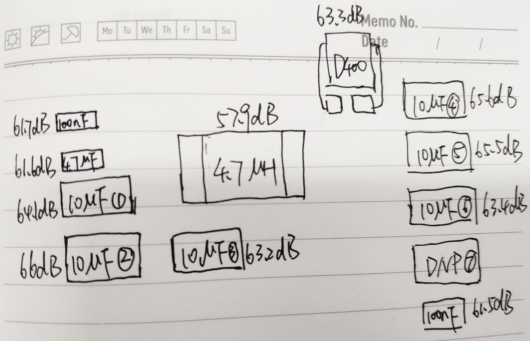

Hi TI team,
As expected, by using PWM dimming product TPS61193, we can hear terrible audible noise, I have uploaded my SCH, can you help to have a look?
From my understanding, the audible noise is coming from PWM dimming's highest and lowest output current, during high current Vout is smaller, during low current Vout is higher. This will make ceramic output capacitor audible.
And this noise is not caused by output ripple voltage when the boost converter's inductor is charging, right? So adding output capacitance is not helping.
What can I do?
Thank you and have a nice holiday...

  • Hello, we measured the approximate position with a microphone. The decibel of the sound at the inductor is about 55dB, and the decibel of the output capacitor is about 62dB. It should be the howling sound from the ceramic capacitor.
    Electrolytic capacitors are a bit bulky and too high in height. At present, we have increased the PWM frequency to 15KHz, and howling has been greatly improved, but it is described in your document that it will affect the linearity of dimming. Is there any other way. Thank you!

  • 1. Is it necessary to replace all ceramic capacitors with tantalum capacitors?
    A:Just replace the cap which generate noise.
    Reply:The values in the picture are the measured sound decibels of each device. When the 10uF capacitors are replaced with tantalum capacitors,
    the howling sound is reduced, but it still exists.
    2. Our customers have no requirements for dimming, but we saw this in TI's documents, so we want to know what kind of negative effect of increasing the PWM frequency on dimming?
    A:You can regard it as decrease of dimming ratio.
