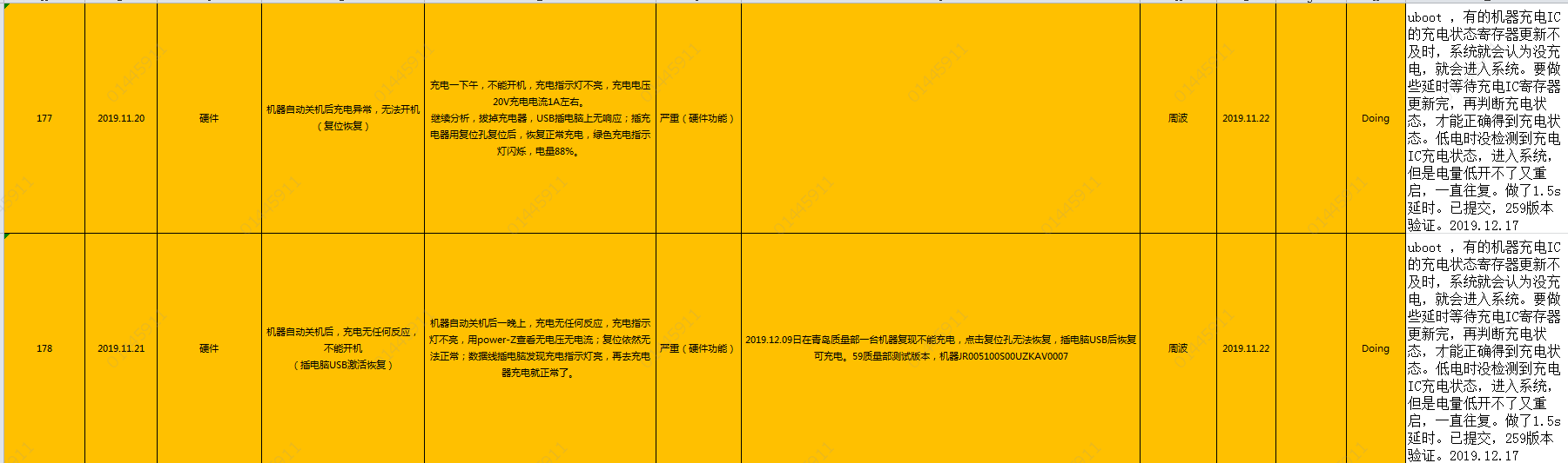

Hi team,
When the electricity of battery runs out and adapter plugs in,  BQ25703A can't enter charging condition. If you understand chinese, please see following picture.

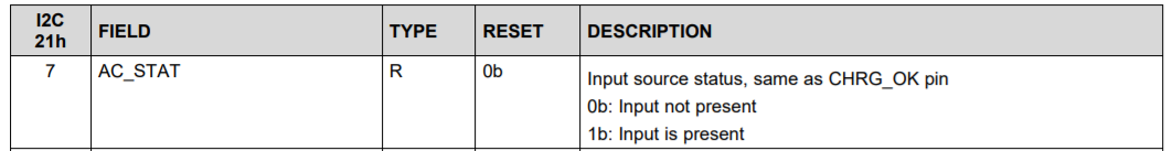

In their schematic diagram, I found that the CHRG_OK pin is not pulled up. Will it result in this problem?
