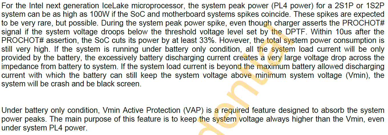

Our customer asked about how VAP mode is operating. When I checked in the datasheet 9.3.2, this function is charging to VBUS capacitor from battery and the charged energy supply to the system for supporting system load current in order to keep VSYS voltage.
Is my understanding correct?
