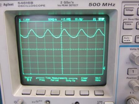

I'm trying to design a number of TPS63020 circuits and snyc them together. My input voltage range is 3.5 - 5.5 V and my desired outputs are as follows:
3V @ 400mA
4V @ 800mA
5V @ 900mA
I can get the 3V and 4V versions working fine but am having trouble with the 5V one. It draws up to 25% more current at 5.5V (in) than it does at 5.0V (in). It also won't regulate when the input is below 4.0V. Are these chip limitations or am I doing something wrong?

  • Attached is a schematic and layout of the circuit which I tried to keep the same as the datasheet. However when it wasn't working I added some more capacitance (2 x 10uF) at the input and output. I have posted a plot of the output when the input is at 5.5 V and the circuit is drawing more current than it should (I tried zooming in the timescale to catch the actual switching frequency but it was too fast for my CRO). I tested the circuit with both a 10 Ohm and a 5 Ohm load and it was doing the same for both. Under "no load" condition the output was fine.

  • Thank you for posting your schematic and layout.  Yes, the XFL4020 will work fine.  A few suggestions:
    Your ceramic input and output caps will lose most of their capacitance due to the DC bias effect.  This is an effect on ceramics--when a ceramic holds a DC bias across its terminals, the effective (real) capacitance decreases.  With 5V or 5.5V on these 6V caps, the real capacitance could be reduced by as much as 80%.  I would get 10V or 16V caps and try again with the same 10uF value.  Also, I assume these are X5R or X7R dielectrics?  Do not use Y5V or Z5U as their capacitance varies too much and they have much worse DC bias characteristics.
    I would try the above first.  With the reduced capacitance, you may be violating equation 6 in the datasheet which gives a minimum value for the capacitance.
    If the above doesn't help, I would then try to lower the impedance of your feedback divider.  With a 2 Meg high side resistance, it will be very susceptible to noise.  I would try lowering the resistors by an order of magnitude--to 200k and 22k--and see if that makes a difference.
    Assuming you have a ground plane on layer 2 that is uninterrupted below the IC, the layout looks fine.  Thank you for copying the EVM's.
  • Thanks Chris,
    I beefed up the voltage on the input and output capacitors to 16V (1206 capacitors) and that seemed to help a lot. The chip was regulating all the way from 3.5 - 5.5. But I found that my current was still varying a lot especially at high voltages. So I reduced the impedance of the feedback divider as you suggested but still no luck. I tracked this issue down to some variable contact in the banana plugs I was using to connect to the power supply. Once I replaced these plugs with a more robust connection it worked fine.
