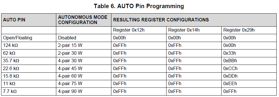

We are using TPS23881 to design an 802.3bt (90-watt) PSE without MCU. My question is that once
I set Rauto to 7.7K ohm (4-pair 90-Watt) , can it be connected with legacy 2-pair 802.3af/at devices?
If I would like the PSE to support upto 90-watt (from 2-watt to 90-watt for both 2-pair and 4-pair) for each port, should I
use autonomous mode and set Rauto to 7.7Kohm?
