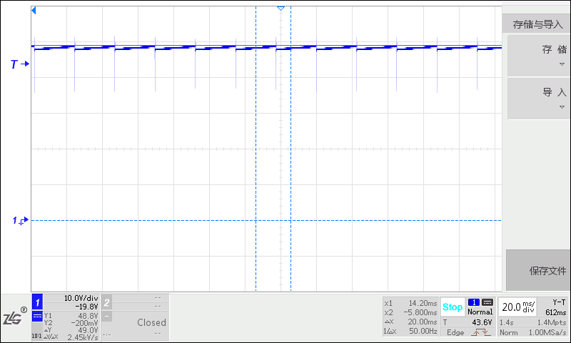

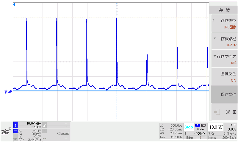

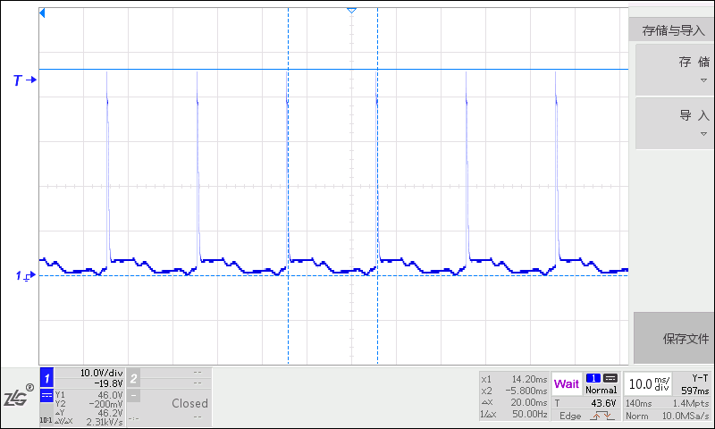

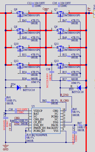

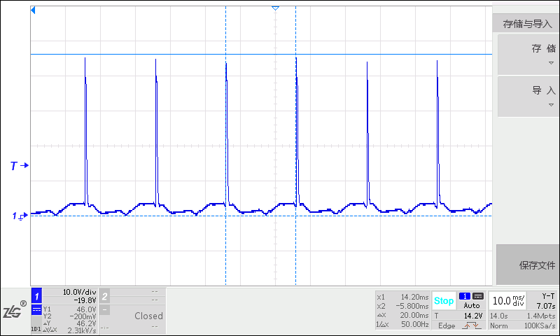

Hi
Attached schematic as below.
1. This problem is encountered in mass production. It is not easy to reproduce at present, and no problems will occur under normal circumstances, so which parameters may not be designed reasonably.
2. The data obtained by the end customer, so what is reproduced now is similar to the phenomenon encountered by customers.

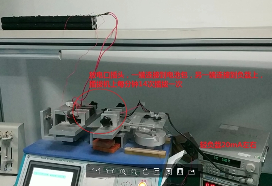

3. When the discharge port is disconnected, the AFE protection chip enters deep sleep, and CHG_EN and DSG_EN output low levels; when the discharge port is connected, the AFE protection chip wakes up from deep sleep, and CHG_EN and DSG_EN output high levels.
4. Test method: Plug and unplug according to the set frequency on the plug-in machine. Light load is always on.

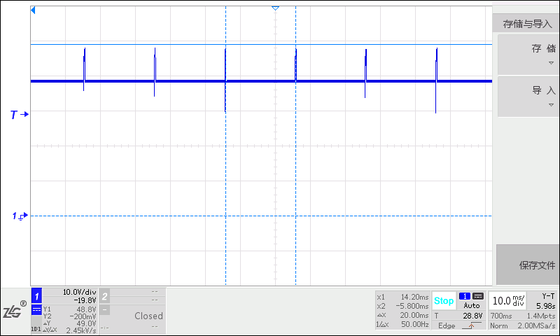

5. Capture the voltage waveforms of the VDDCP, PACK, CHG, DSG pins on the BQ76200 (the ground of the oscilloscope probe is all connected to the battery pack B-), and the Voltage waveform. The time interval from the waveform is 20ms.
6. I have checked the temperature and voltage characteristic curve of the 2.2uf capacitor on VDDCP, and combined with the test situation, the influence of the capacitance change of the temperature capacitor can be basically eliminated; there is no leakage of the 16V voltage regulator tube between the GS pin of the discharge MOS In some cases, the MOS hiccup phenomenon still exists after the voltage regulator tube is removed, and the universal transformer string cannot detect the current on the voltage regulator tube circuit.

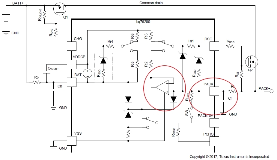

This internal block diagram (especially the red circle) does not read the working mechanism in the document. Can you help explain what possible reflow paths can cause this phenomenon that we caught, and what can be solved method?
Waveforms at various points during abnormal times (all probes are connected to the B-test):
PACK waveform
B+/B waveform
CHG pin voltage (CHG_EN normally outputs 11V at this time)
DSG pin voltage (CHG_EN normally outputs 11V at this time)
VDDCP pin voltage
P+/P- voltage

  • Hi Star,
    Our expert on this device is on vacation this week, but I can offer some comment based on my limited understanding of this device.
    You might look carefully at whether the VDDCP voltage is dropping below the UVLO threshold when the FETs are enabled.  This may cause them to be disabled quickly, resulting in a pulse train.  See fig.5 in http://www.ti.com/lit/an/slua794/slua794.pdf for an example.  This can occur if your FET capacitive loading is too high versus the capacitance you have on VDDCP.
    Since this seems difficult to reproduce, it may be that you are close to the edge of the acceptable capacitive load, you may try experimenting with a larger cap on VDDCP.
    Another possibility is excessive loading at initial discharge turn-on, you can see some discussion of this in http://www.ti.com/lit/an/slva729a/slva729a.pd and some pertinent plots in figures 37 and 38.
