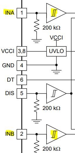

Could you tell me the input current specifications of INA pin and INB pin?
The driving condition is 200kHz to 700kHz.
Customers want to know how much input current INA pin and INB pin need.

  • Hi Yusuke-san,
    These input pins have an integrated pull-down resistor which is nominally 200kΩ.
    The peak input current will be approximately Iin = Vin/200k.
    The average input current will scale with duty cycle, approximately Iin(avg) = Vin/200k*D.

    Let me know one more thing.
    Could you tell me the input impedance of the buffer with hysteresis?
    Customer thinks this impedance contributes to input current.
    Yusuke
  • Hi Yusuke,
    The input buffer is CMOS based and designed for minimum input capacitance. It does not add significant input current at these frequencies, compared to the input current from the 200k pull-down. I will typically assume input pin capacitance is ~1pF for these types of logic level inputs.
