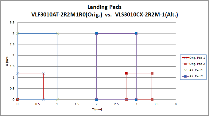

We have been using TPS62420 for many years in a number of our reference designs, and its been working great! As part of this design we have been using 2 of the recommended inductors, VLF3010AT-2R2 and VLF3010AT-3R3.
These inductors have recently been marked as obsolete, looking at Digi-Key there wasn't a great pad-to-pad drop in. What are your recommendations? It is crucial that we find one which is able to be soldered into existing designs without modifications to their layouts.
