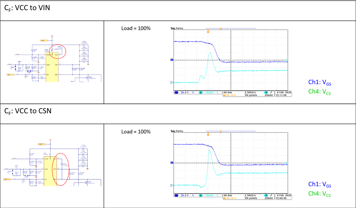

  • Hi Irwin,
    Please refer the below figure for leading edge waveform with vin and csn situation.
    May I know the margin of limitation of it? Not sure whether it has shown on datasheet or not.
    If our understanding is correct, the current dropping of false trigger is dependent with the pwm cycle? Thank for your help.
    It appears the leading edge on these two pictures is about 60 ns.  Typical leading edge blanking is 115 ns for the LM3409.  It would also be helpful to see the actual current ramp after the MOSFET turn on to see how much ripple there is.  Is there a gate resistor used?
    It appears it will function fine either way however worst case analysis should be looked at.
    Regardless, going with the datasheet recommendations is best.
