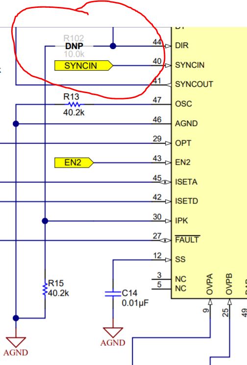

Customer want to know the function of R102. Although it is DNP, what is the original purpose as it is connected to IPK, not directly to GND?
Because INP internally has a current source, which will provide a 1V bias at 40.2k resistor.

This resistor helps to adjust the peak current limit between the buck and boost modes. According to the datasheet EC table, you can see that the buck and boost modes has different peak current limit settings. This resistor can help reduce the difference.

Hi Youhao,
Thanks for reply. But DIR is logic high in buck mode and logic low in boost mode. IPK buck is 46mV/V and IPK boost is 48mV/V.
When DIR is logic high, is IPK voltage determined by the resistor divider or the internal current source?
When DIR is logic low, is the IPK voltage determined by the 25uA * (R102//R15)? Thanks.
