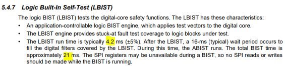

The following contents are described in the data sheet.
Which Is period of the following can not be accessed by the SPI?
1.4.2msec after ”Reset→Diagnostic”
2.21msec(±5%)
Could you give me your advice?
Yusuke
2.21msec(±5%)
Yusuke

It is probably no access to SPI during the total BIST time of 21ms. I'm not sure if SPI is accessible after 4.2ms run time and will find out.
