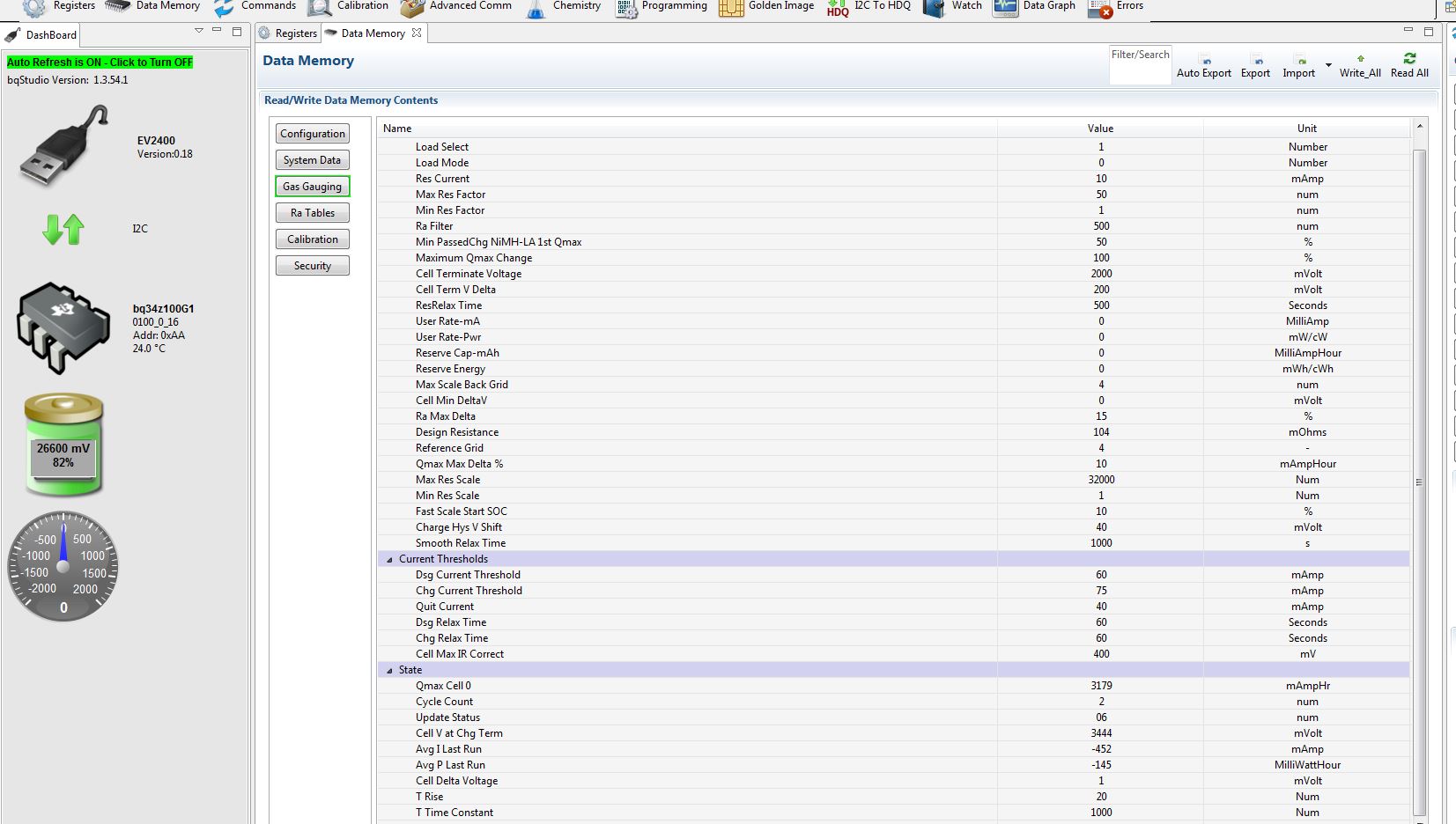

I am using a BQ34z100-g1 with an 8s2p LiFePO4 batteries. The nominal capacity of the battery is 3200mAh.
I have obtained the golden image of the battery and load it in the bq34z100-g1 and now I am doing cycles to the system simulating the real application.
My discharge cycles only takes about 10 seconds each time they are occur (they occur more than 100 times per day) so I need the bq34z100-g1 to take the resistance measurement inside these 10 seconds.
To achieve it I have read in the Technical reference ( ) that Quit Relax Time mus be set to the desired time.
However I can not find this parameter in the bqStudio to modify it. You can see in the following image the screen of the bqStudio (Gas Gauging section)
I can see Discharge Relax Time and Charge Relax Time.
Where can I find Quit Relax TIme?
