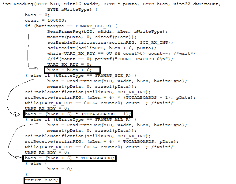

Also, we don't understand how does the ReadReg function work, because in the bq79606.c it is defined in order to always return 7 (because bLen is 1), so how can we see the actual value of what we're trying to read?

    To answer your second question, to read the data, you do not read the bRes variable. The bRes variable is only to determine the number of bytes that were received.
    To read the data response, you must look at the array of data that gets stored in pData. The array that you pass to the ReadReg function (pData) gets overwritten with the bytes you read.
    This will always be 6 bytes longer (per board) than the number of data bytes, because there is:
    init (1 byte)
    board ID (1 byte)
    register ID bytes (2 bytes)
    [DATA BYTES HERE]
    CRC (2 bytes)
    ^THIS IS FOR EVERY BOARD
    Please review the "Command and Response Protocol Layer" section of the datasheet for more details.

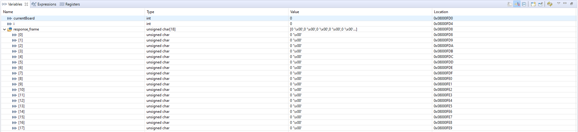

    In the response frame issue, here I show you how we just recieve 0'\x00' even everything is well connected (at least as shown in the typical applications of the data sheet). Could this be a hardware issue of the TMS57004? Because we have read a pair of posts in this forum, where they recommended to remove the R8 and R9 resistences, which is also said in the EXAMPLE-CODE's sys_main.c's description. Should we do this? Why?

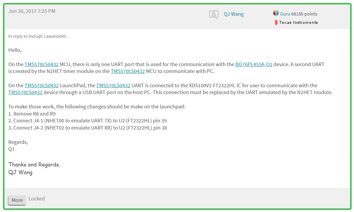

    We have removed the R8 from the LAUNCHXL-TMS57004 as required but nothing has changed, because we still recieve all 0 in the response frame, as showed in the previous comment. We don't know what more to try, because we have read everything online and the only user we found that had this problem, had it solved by removing the R8 resistor, but what shocked us from the answers from that post, hosted in this forum, was this particular answer where the writer suggests to remove both R8 and R9 and also connect J4-1 to pin 39 of the U2 and J4-2 to pin 38 of also the U2. Should we try this in order to make our UART connection work?

  • Hi Alex,
    From the image it looks like “i” is still zero. Have you pressed run on the program (green play button at top of code composer studio window)?
    If so, can you see what happens when you instead step through the code using the buttons next to the play button, and see if the any values are getting updated during that part of the code?
    Lastly, please probe RX/TX of the microcontroller to see if the commands are being sent and the response is being sent (check if one of the two is not happening).
