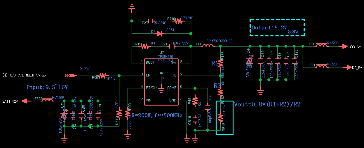

Hi Team,
My customer use TPS54540 as the first power stage in automotive. change 12V to 5V.
However, met the following problem: ACC ignition power does not start. It means it can't work in STAR-STOP when Vin drop to 8V.
When the Vin is 8V, output is sawtooth wave..when Vin is lower than 8V, the output goes down..
As my understand, if Vout =5V, the minimum Vin is 5.7V. 8V is much higher than 5.7V. Why it doesn't work?
Any advice?
Thanks!
