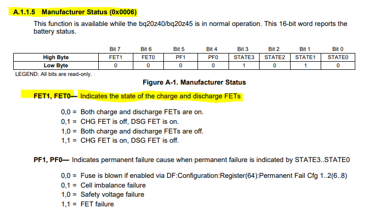

Hi Team ,
my customer project's application have battery pack which use BQ20z45 as gauge and having a issue on SMbus communication.
In their using case,the processor will read the BQ20z45's data to check the information around 7 secs interval. It could run some time with no problem to read the normal read data from gas gauge, but sometime the SMbus would happen to hang up that the SMBD data line was kept low and SMBC kept high. then the communication is fail and can't recovery until remove the battery pack from processor bus and re-mount again.
please kindly help to clarify  what condition will cause this issue and how to solve , thanks a lot in advance!
