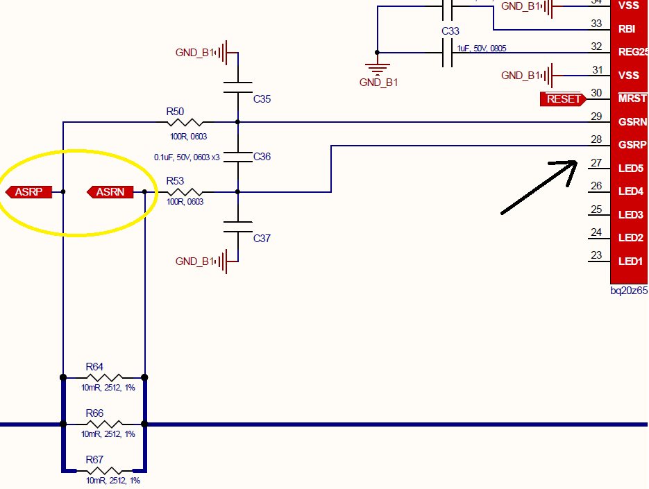

  • Hi Andy,
    I've realized that I did big mistake on schematic. I was trying to perform learning cycle for weeks. Finally I can achive update status 0E.
    My mistake was at SRP-SRN pins of the IC. They are connected wrong side of sens resistor as shown in the picture. Therefore when I discharge the battery in calibration mode it shows positive current reading. I just thought that is normal and miscalibrated, I continued to make calibration. After current calibration I can read correct measurement.
    But coulomb counting circuitry in gauge reads current the exact opposite I guess. I've made some modifications on BMS circuit and I tied SPR/SRN pins correctly. After that implementation I could achive correct learning cycle.
    I have problem with over 200 Bms PCBs which waiting to deliver customer. PCB's produced and components assembled.
    My questions are;
    Can I use those BMS's with my Golden File(.rom) and good calibration?
    What can go wrong after years of usage?
    Maybe Ra table updates or Qmax disabled?
    Capacity estimation can be wrong?
    Thanks for your help.

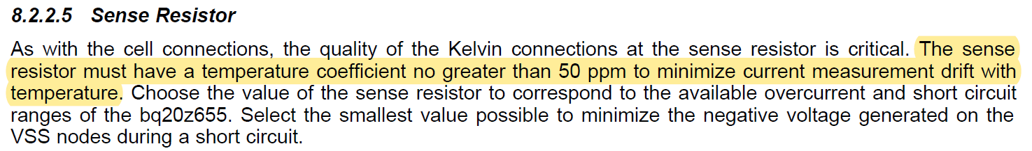

  • Mett,
    It is good to hear that you have solved your problem.
    If the sensor resistor you use is one of good quality (below is our recommendation in the datasheet),  we don’t think calibrating each device would be necessary and you can use your golden file with good calibration.
    Both QMax and Ra table will be always updated automatically by the gauge as long as it is working.
    Andy
  • Hi Andy,
    Thanks for your helpful reply. But I didn’t mean that I’ve corrected connections of 200 pieces of pcb. They are already assambled and coated with conformal. I cannot change Srp/Srn pins. I’ve just modified tracks of two pcb’s for learning purposes.
    My question is that Can I use that Pcb’s with wrong connection?
    Just doing calibration and sending golden file. What can go wrong after usage?
    Thanks.
  • Hi Mett,
    I would suggest you go ahead and fix the boards since it is a hardware bug.  We can only guarantee that the gauge firmware can perform properly when there is NO hardware issue.
    Andy
  • Hi Andy,
    I will try to find a solution for hardware problem. If I can’t I have to send it with  just doing calibration and upload golden file.
