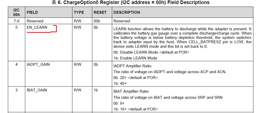

Hi Sir,
 If bq25703 can select battery charge to system when adapter plug-in?
I checked below register looks like this means, or is others meaning?
Thanks, Ian.
  • Hey Ian,
    This register bit does have this function. EN_LEARN is used mainly for calibrating a gauge while the adapter is present.
    You may also consider using the EN_HIZ bit in the ChargeOption3() register. This will also disable the converter which allows the battery to discharge directly to the system.
