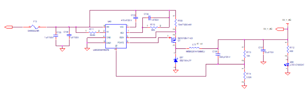

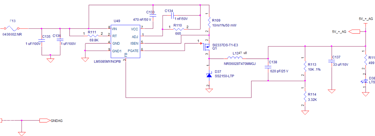

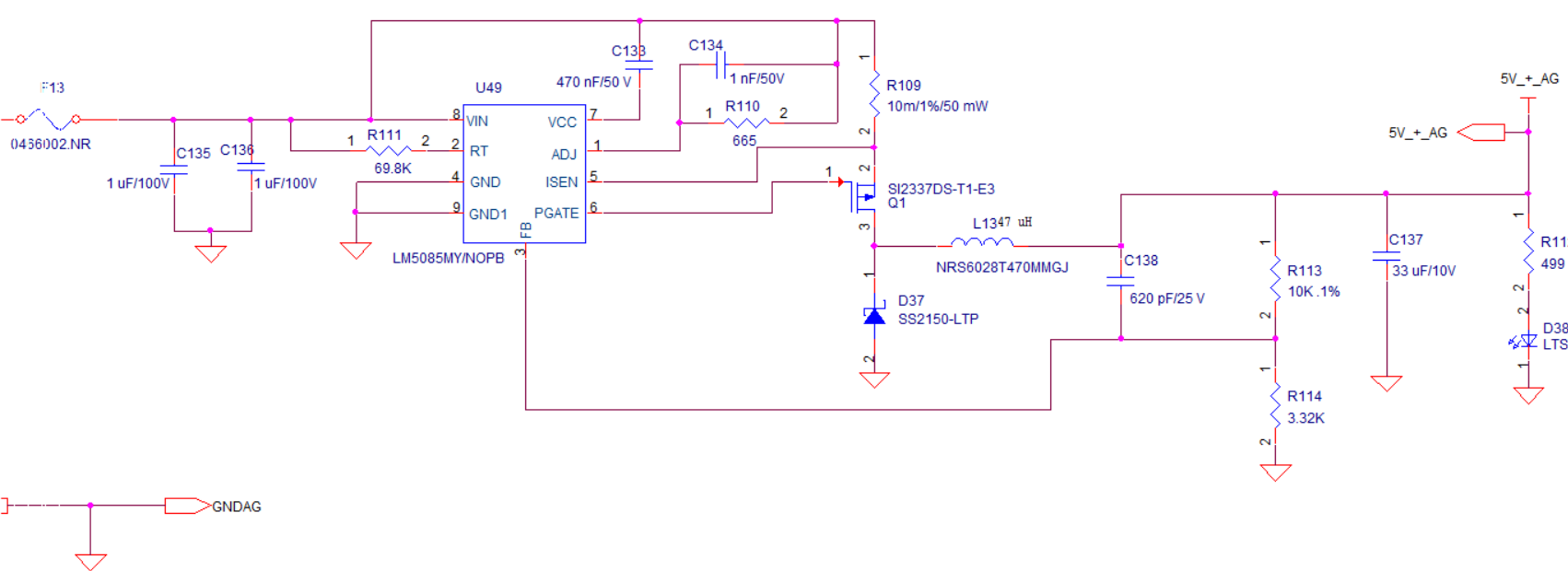

The input (Vin) varies from 33V to 55 V and the output required is 5 V.
The power system shuts down with voltages above 19 V.
The circuit functions in a standalone breakout pcb.
When I transferred the circuit to the integrated PCBA, the circuit does not function even so all components are identical to the ones on the breakout board.
Anyone had similar problems?
