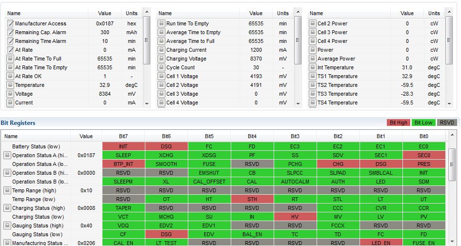

Section 4.6 of sluuaq3 states the following criteria is necessary for VCT to be set but my setup is configured like this and it never happens:
BatteryStatus()[DSG] = 0
- AverageCurrent() < "Advanced Charge Algorithm/Termination Config/Charge Term Taper Current
(drops from 983mA down to 0mA ) < 250mA
ChargingVoltage() / num of serial cells ≤ "Max cell voltage1..4" + "Advanced Charge Algorithm/Termination Config/Charge Term Voltage" (75 mV)
(8370mV / 2) < (4189mV + 1mV)         (Note, the battery voltage goes up to 4191.  The 4189mV was reached when the current was at 250mA)
- the accumulated change in capacity > 0.25 mAh
2675mAh when the charging current is at 250mA and 3681mAh two minutes later
There are no safety errors and DSG does not equal 1.
The CEDV works correctly and the gas gauge will identify the end of battery life but I've not been able to get VCT to trigger and adjust the RSOC.

  • Here is the full log of every register during a charge from completely dead until the current goes below the 250mA threshold.  I stopped the log when it reached 180mA which was 11 minutes after the 150mA threshold and 19mAh of energy accumulation.  For some reason, the "Remaining Capacity" register sopped counting at 4058 even though the charging current wasn't at 0mA.  The "CEDV RC" register still increased until the logging stopped though.
    I'm trying to get the "ChargingStatus" register to enable the VCT bit and change the "Remaining Capacity" register to equal the "Full Charge Capacity" register (4100mAh) but the "ChargingStatus" register stays at 0x8008.
    5153.Full log for TI.log.xlsx

    Here is the information you requested.  The "1_17_charge for TI.xlsx" log contains 14 minutes of relaxed time before the charging started.  The "1_17_relaxed.gg.csv" GG file was taken before the charging started and the "1_17 after charge for TI.gg.csv" was taken after the charging stopped.
    This log also shows the other issue I'm seeing with this setup.  The "Remaining Capacity" register gets stuck at 4058mAh and doesn't increase even though there is current going to the batteries.  The CEDV RC register keeps counting though.  I'm not sure if these two issues are related.

    In your log, you did not send GAUGE_EN command. That bit is cleared.
  • Hi Kang,
    I do not believe the GAUGE_EN bit can be read from the ManufacturerAccess() 0x0057 ManufacturingStatus register.  This is the register which is stored in the log I provided.  In section 13.1.39 of sluuaq3, the bit descriptions of this register does not have GAUGE_EN.  I believe it would be bit 3 but this bit is RSVD.
    I do have GAUGE_EN set in the Manufacturing Status Init register (Section 14.3.1) although this bit shows up as RSVD in the TI Battery Management Studio when you select the BQ4050.  I'm not sure if this is a bug with the BMS or if the BQ4050 really doesn't have this GAUGE_EN bit.  There isn't a command to set it described in the sluuaq3.
