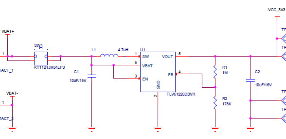

TLV61220: Vout can't reach 3.3V for Vin from 1.5V to 3V
Part Number: TLV61220

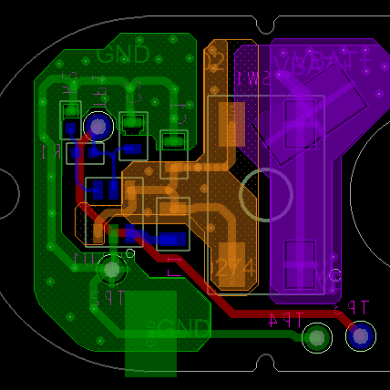

Good day. I am using this Boost IC for Vout 3.3V, 40mA  for the input voltage range from 1.5V to 3V. But it is not working as per the Webench simulation report. The Schematic circuit, BOM and waveform for various nodes are given for your reference. Kindly provide the solution to solve this issue.
C1, C2 10µF ±10% 16V Ceramic Capacitor X5R 0603 (1608 Metric) Murata Electronics GRM188R61C106KAALJ
L1 FIXED IND 4.7UH 1.1A 160 MOHM TDK MLP2016H4R7MT0S1
U1 Boost Switching Regulator IC Positive Adjustable 1.8V 1 Output 220mA (Switch) SOT-23-6 Texas Instruments TLV61220DBVR
R1 1 MOhms ±1% 0.063W, 1/16W Chip Resistor 0402 (1005 Metric)  Thick Film Vishay Dale CRCW04021M00FKEDC
R2 178 kOhms ±1% 0.063W, 1/16W Chip Resistor 0402 (1005 Metric) Automotive AEC-Q200 Thick Film Vishay Dale CRCW0402178KFKED

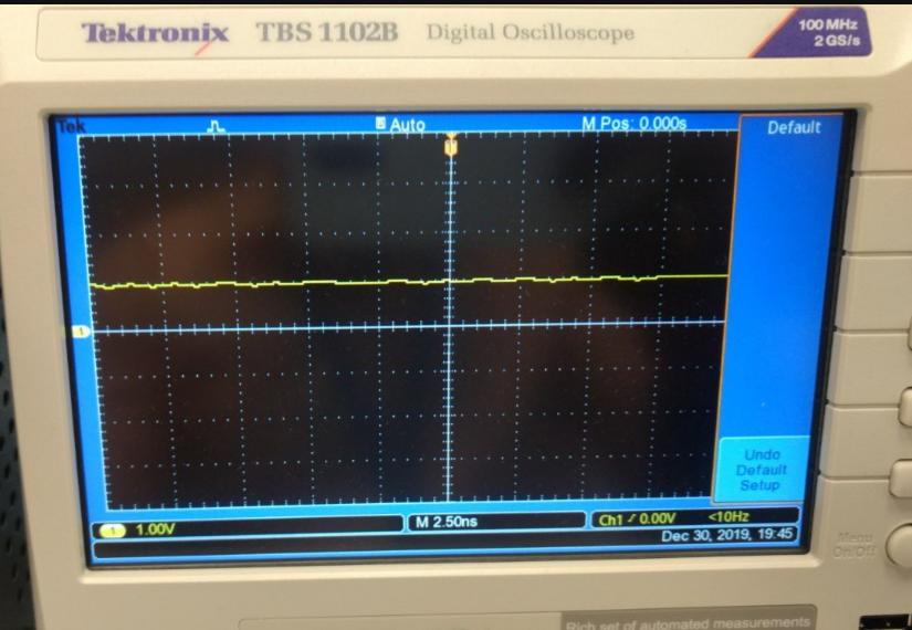

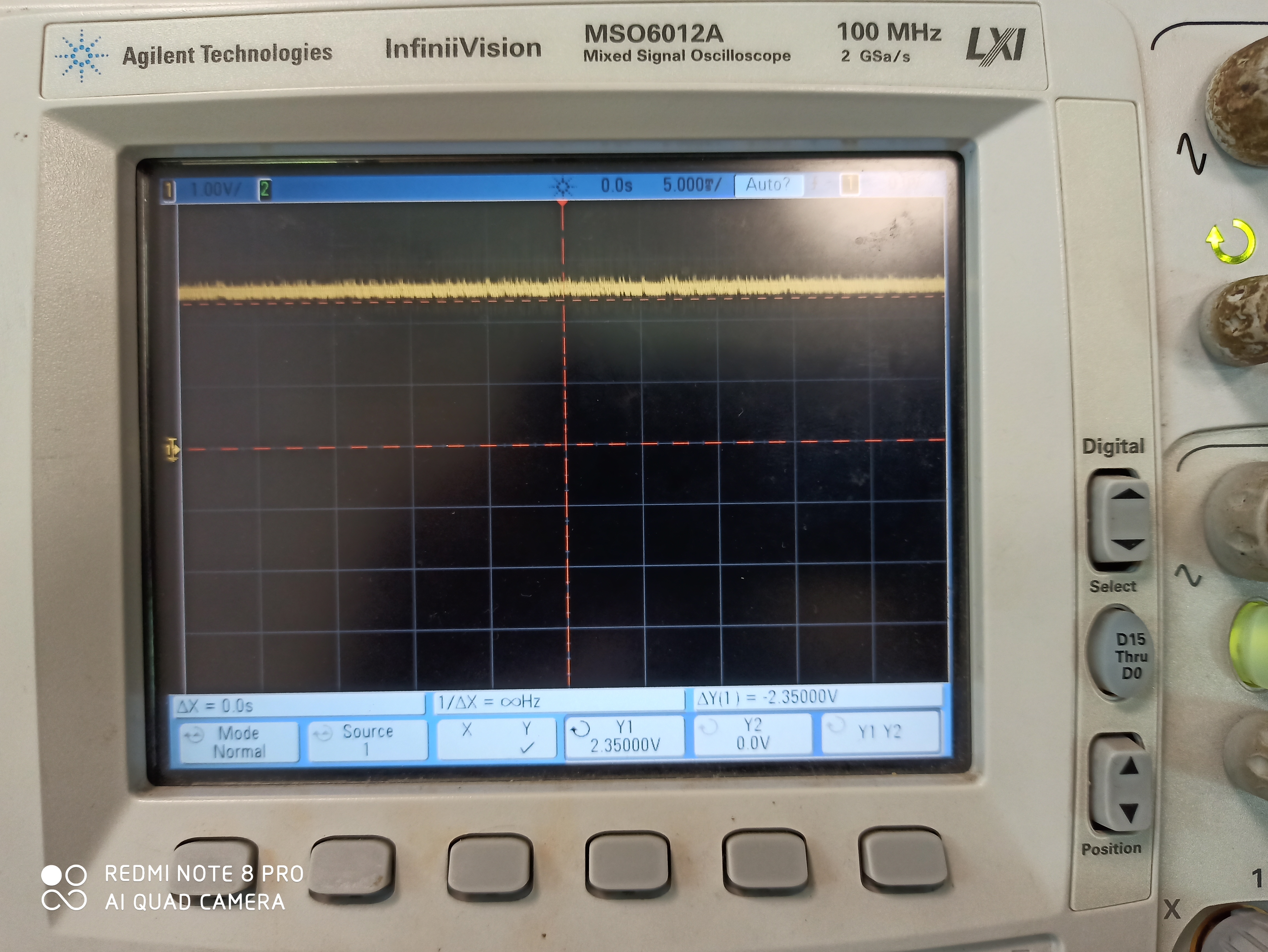

1.  Output voltage graph at 3V input (Vout 2.4V instead of 3.3V)
2. Feedback voltage graph
