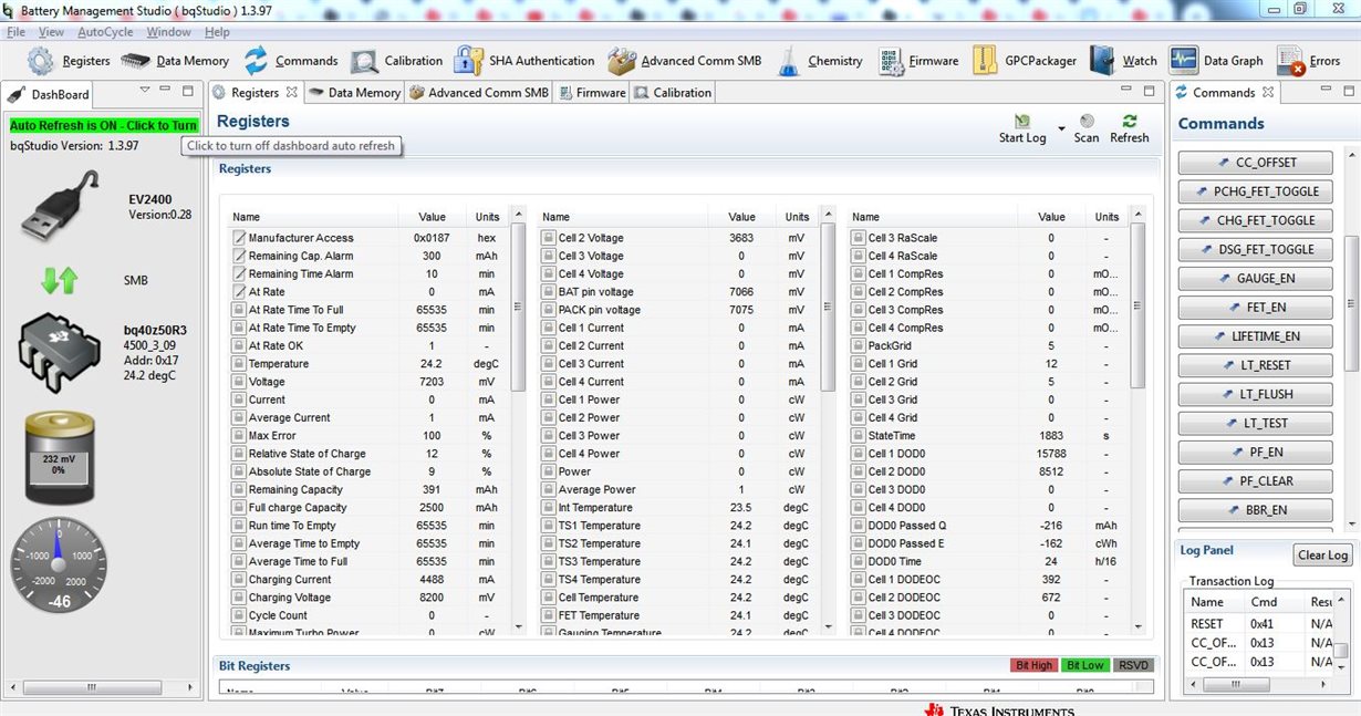

I have generated the golden file for 2s-2p battery configuration,and We have Developed the PCB as per the TI Documents. On New PCB we observed that Actual and Read Current is not matching .
Please suggest how to calibrate my BOARD OFFSET and CC OFFSET. for fixing the drooping of current.
I attached snapshots during charge,discharge and rest time,gg files for your reference.

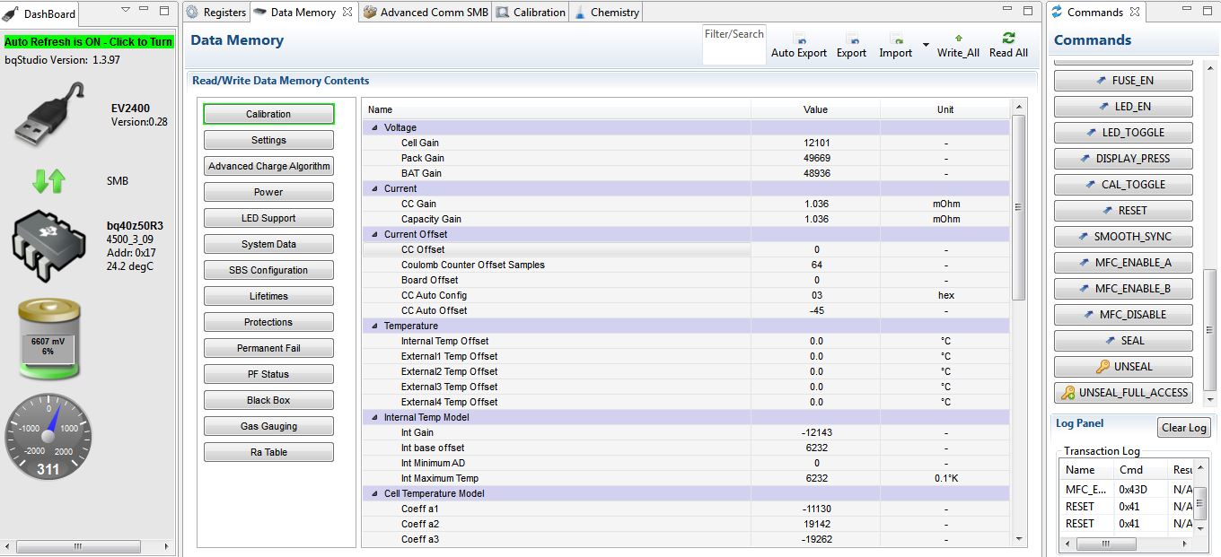

        The snapshot is for DataRam, currnet can only be read in Register Page and Calibration page, please upload Register Page or Calibration Page to read the current.
        Calibration is also simple, just make sure no current flow throw the sense resistor as the prerequisites, then check cc offset, press calibration button, after cc offset calibration is done, then check the board offset and click the calibration button, the board offset would be done after a while

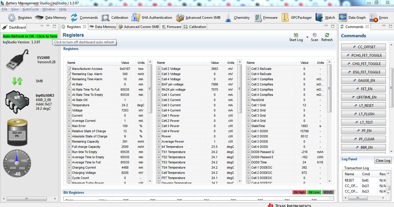

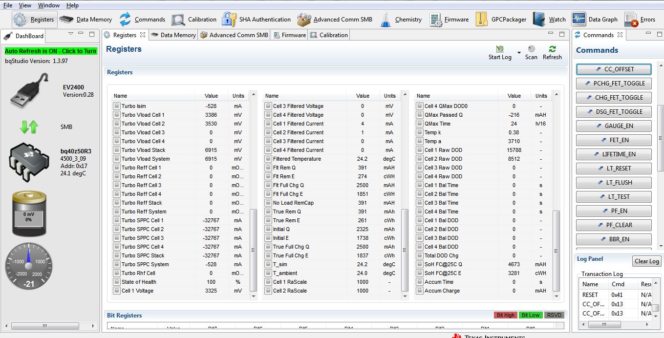

  • Hi Steven ,
    We are not finding the options that you have mentioned in response. We tried CC offset Command 0x13, but of no use. At no load current drawn in Display is -48ma. Also uploaded the Register snap shots as requested.

  • Hello Vishwaradhya,
    Can you try using the Calibration plug-in in bqStudio?
