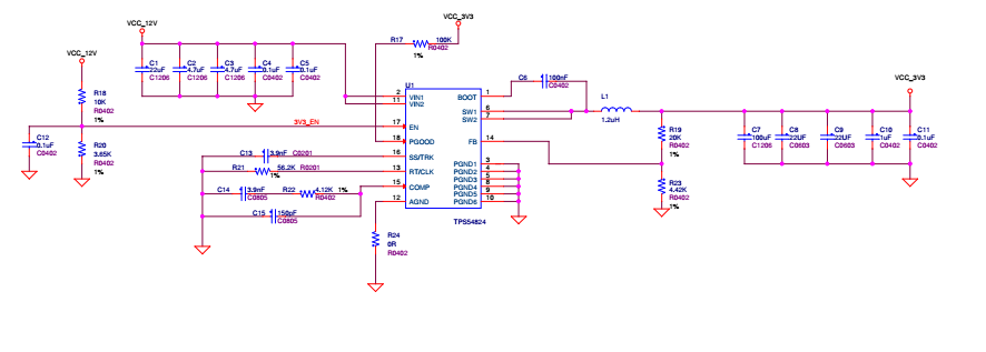

I have designed the schematics for 12V input to 3.3V, 6A output using the TPS54824 device.
Kindly review and let me know the review feedback.

Recommend to reserve one more 22uf input cap and place the input cap at both two Vin pins symmetrically and reserve a 47pf cap parallel with the upper FB resistor R19. Others looks ok.
