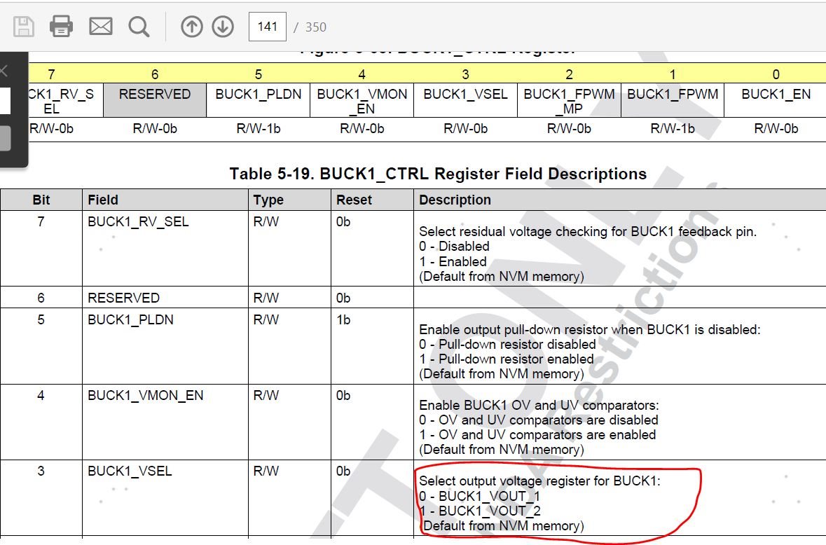

We find the have two output setting for each Buck, how to understanding this setting?
and what are the usage of the BUCKn_VOUT1 and BUCKn_VOUT_2?

       All of bucks on the TPS65941-Q1 device support AVS and DVS voltage scaling changes. Once the AVS/DVS voltage value is written into the BUCKn_VSET1 or BUCKn_VSET2 register, and the MCU sets the BUCKn_VSEL register to select the AVS/DVS voltage, the output of the buck will maintain the AVS/DVS voltage level instead of the default voltage from NVM until any one of the following event occurs:
    • Error that causes the device to re-initialize itself through a power cycle after reaching the SAFE RECOVERY state
    • Error that causes the device to execute warm reset
    • MCU configures the device to enter the LP STANDBY state

    1.If the BUCKn_VSET1 is for AVS and BUCKn_VSET2 for DVS?
    2.if both of BUCKn_VSET1 and BUCK_VSET2 are setting for AVS?
    3.While the BUCK1 was used to AVS mode, how to set the  BUCKn_VSET1 and BUCKn_VSET2?
    4.While the BUCK1 was used to AVS mode for CPU CORE power supply,what is the adaptive voltage range of the BUCK1?
    Thanks a lot!
  • Hi, Dechun,
    A1: No, both AVS/DVS need 2 different voltage levels, the BUCKn_VSET1and  BUCKn_VSET2 are used to setup these 2 different voltage levels.
    A2: Between DVS and AVS, the primary difference is that the former has an open loop control architecture whereas the latter is closed-loop. That is, in AVS there is direct feedback between the performance of the chip and the voltage provided to it.
    A3: Answered by A2.
    A4: The adaptive voltage range depends on application and its processor specs.
  • Hi, Phil,
    What is the purpose of using 2 different voltage levels? For up limition and low limition? or other purpose?
  •  Hi, Dechun,
       The purpose of using 2 different voltage levels is to reduce unnecessary power usage and heat generation when system is not running in high performance status for higher system efficiency and longer battery life.
