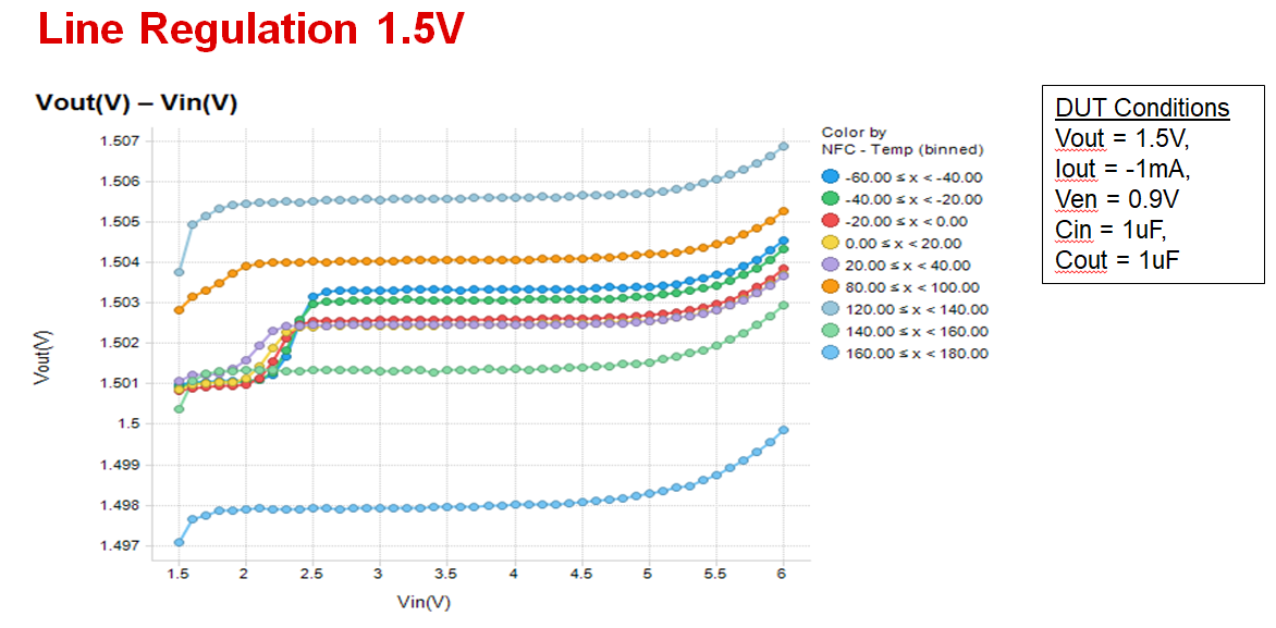

I've been asked by Customer as below.
part number : TLV75801PDBVR
request 1.
Could you try to have the line regulation with specific condition Customer will use to provide for customer?
the graph datasheet provided is different condition, it would be nice if we could provide it with specific customer requirement
Vout=1.5V、Iout=0.33A
input voltage changes from 2.8V ~ 6Vin
request 2.
Could you try to have the load regulation with specific condition Customer will use to provide for customer?
VIN=1.8V、Vout=1.5V、
Iout changes =0 ~ 0.33A
i understand that customer has to do this by themselves but just asking to see if we could provide or not.
please tell me to know we could support on this or not .
