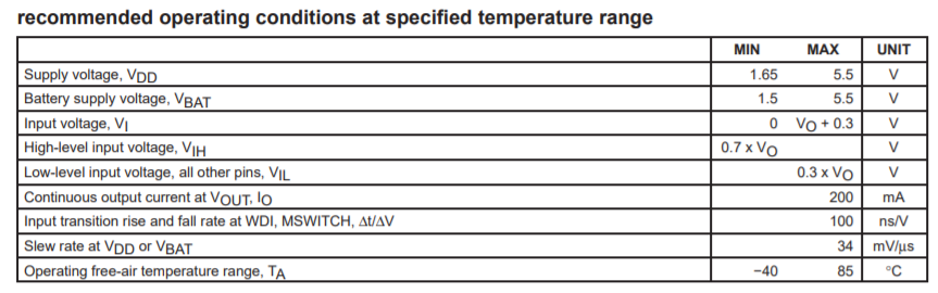

  • Hi Gautam,
    The reason for this is Vbat(min), as defined in the recommended operating conditions as shown below. You need to keep Vbat above 1.5V for proper response.
    Abhinav.

  • Vinayak,
    The officially supported value for minimum Vdd is 1.5 V. Past this, it could work, but it cannot be well defined and thus guaranteed.
    Abhinav.
