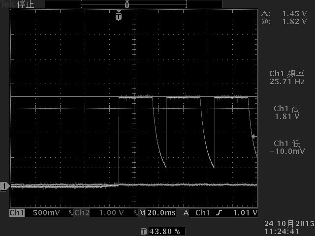

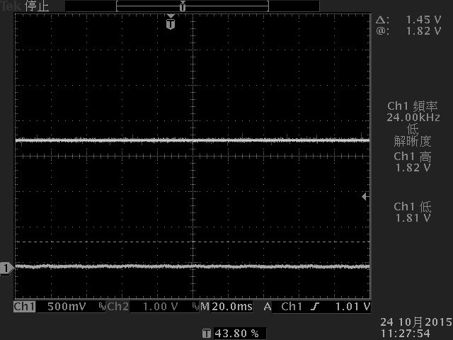

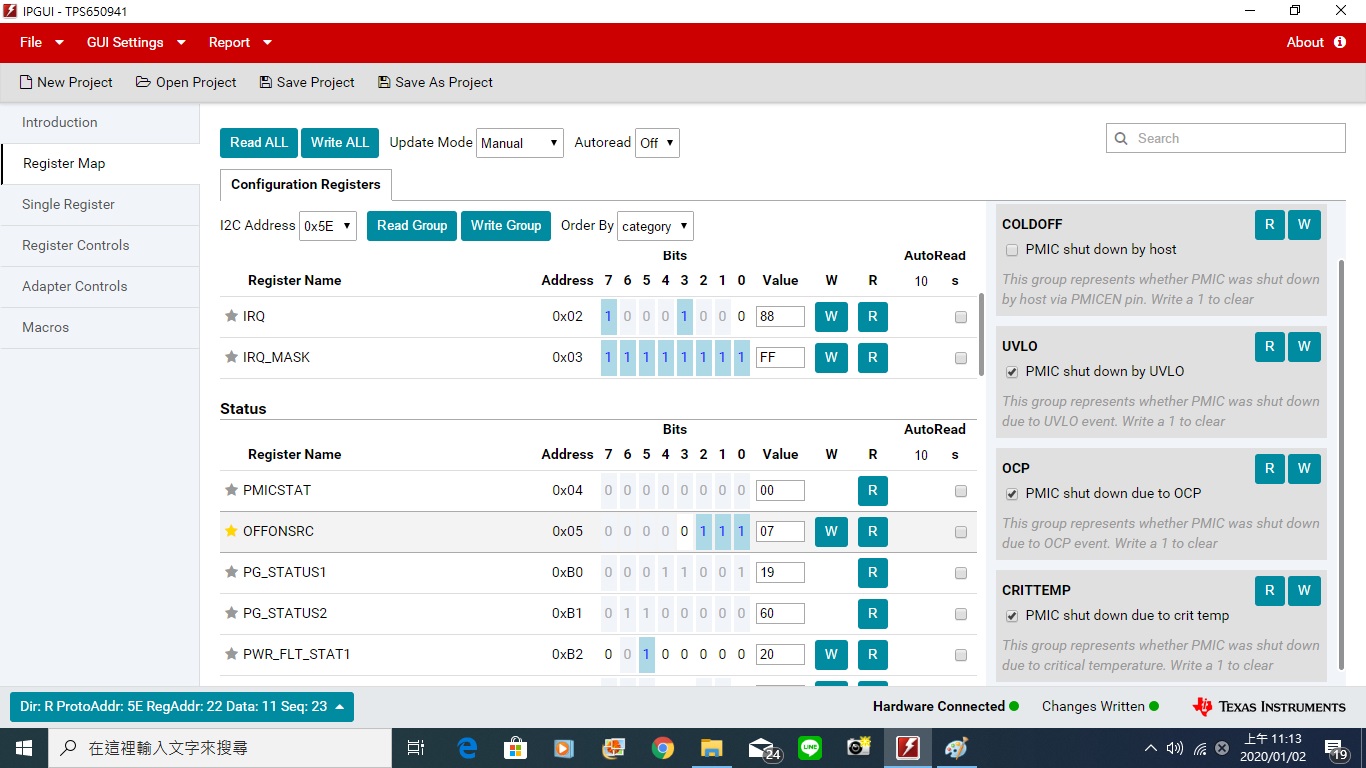

My target board APL, ATX power  PMIC Ti TPS650942  follow power on sequence  ATX5VSB>dc to dc>VSYS(6V)>LDO5V>V5ANA>PMICEN>RSMRST    VNN, V1P8A,V1P24A  Vin 5Vdual  use USB2ANY read out the register. PMIC shut down by UVLO,OCP  measure the V1P8A wave form as follow  power up moment seems V1P8A shut down and retry but few ms. V1P8A steady state is stable  i attached IPGUI project file could you make a diagnostic which one cause this
