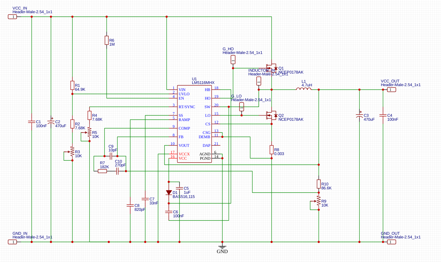

LM5116: Low Side MOSFET burns after shorting out output.
Part Number: LM5116
Hi
Im trying to do some tests with LM5116 (basically DC/DC buck converter 24-48V input to 12V-24V Output)
Below is schematic used - adopted from Wbench.
After connecting to 48V input DC and setting freq to 182kHz switching / and 12V output +  shorting out output - low side mosfet is instantly damaged.
Currently connecting to osciloscope to check what i can catch on gate input/sw input lo and ho outputs.
Calculated by wbench to limit current to 20Amps.
