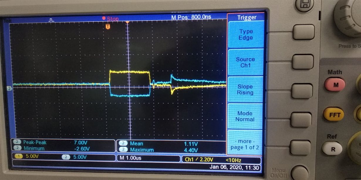

Phy damaged issue is resolved by putting Bidirection TVS on Differential line and Unidirectional TVS on Each line Tx+/- and Rx+/- at phy side.
Above is test at POE switch (PSE) adapter (48V/2A) with earth connection but without earth  up to 40V for 0.5us-2us are comes when plug /unplug event of POE connector (J4). that is the new issue for us.
so now without earth why up to 40v are comes on differential pair at the time of plug/unplug of POE connector (J4).
Please note that up to 40v are comes without any protection diode connected on differential pair it is reduce up to 15-20v when connected TVS diode.
Attached waveform is differential line RXP-RXN with tvs protection and with Earth connected in POE switch.
Note- without earth means no earth connected in POE switch (PSE) adapter.and earth means earth connected in POE switch adapter.

PSE is connected to earth that time also spikes are comes between 10-15V(without TVS).
and when if we add the TVS diode the spike is reduced to 15-20V this cause also damage but very rare (reduced freq.)
and if we connect the earth to PSE and connect TVS diode that time no damged phy.
My aim of explanation is that without earth connect to PSE, PHY damaged at the present of TVS diode.freq is less but it is damaged.

    Yes, we have used filter circuit at POE input side after Bridge rectifier D42 220E,2A FB at VDD and VSS 2.2nf cap at input, 2.2nf at output side as per PMP23154 .
    We have also used clamping diode at differential line(S43LCC0403)and Uni dir. diode (ESD8351HT1G) at each Common mode diode .after that Voltage clamp at 4.5 to 5V .see attached waveform .
    also added spikes waveform at plug/unplug event.
    As per above observation there are two types of waveform 1) 1us -3us 2)10 to 100ns
    also measure the power -64w-100w @10-30ns
    Also contact with PHY support.
    Irfan

    Device working voltage is 3.3V. can you tell me that we had selected tvs diode is right or wrong selected ? we have used S43LCC0403 bi directional diode on diff line i.e 1)TXP and TXN 2) RXP and RXN.
    also used  ESD8351HT1G single endded diode on all 04 pins i.e TXP,TXN,RXP,RXN.
    (http://ww1.microchip.com/downloads/en/DeviceDoc/00001987A.pdf )  5.1 Absolute Maximum Ratings*   ,
    Positive voltage on input signal pins, with respect to ground (see Note 2) ............................................... VDDIO + 2.0 V    it means 3.3+2V=5.3V  sustain at phy pins am i right or wrong
    Irfan
  • Irfan,
    The diode seems fine. As long as the diode is clamping the voltage under the max rating.
