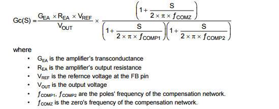

Based on the values of C5, C8 and R5, am I supposed to calculate f_comz, f_comp1, f_comp2?
Is it possible to show me the calculation formula on how to deduce the f_comz, f_comp1, f_comp2? I can't get the formula by equation 17 in the datasheet.
Thank you for your time.
