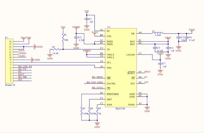

Hi team,
We use BQ25120A in our design, we meet some question.
1. we read the status and ship mode control register during charging , the register hints the status is ready not charging.
2.We close the safety timer limit in VIN_DPM and Timers Register, after charging for long time, device enters into default mode, and the output voltage is 1.8V . we try to communicate on I2C ,but fail until we take off the battery.
We are confused on this problem. Would you pls give us some recommendation on this issue.
Thanks a lot.
