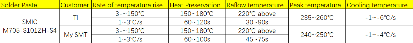

Below is the comparison my SMT temperature curve with TI, please help me check my SMT temperature curve is OK ?

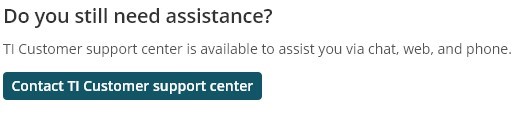

I recommend you direct this question to TI customer support - the site is located here: http://www.ti.com/guidedsupport/call-ti-support
E2E is for questions on device usage and application related questions.

I had check this link, but it can not resolve my question, could you share me the detail link or method ?
