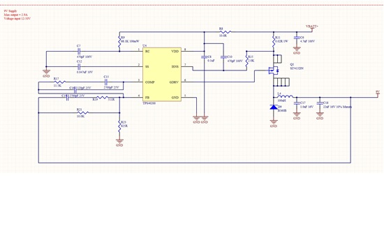

I am having a problem with a circuit that uses the TPS40200. I used SwitcherPro to design a 9V power supply with the following inputs:
Vin Min = 12V
Vin Max = 50V
Vout = 9V
Iout Max = 2.9A

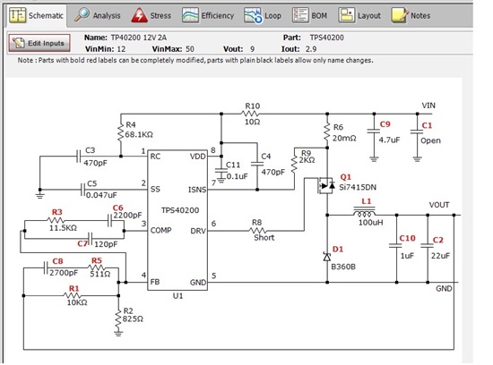

SwitcherPro gave me the following circuit, which I duplicated into my schematic:
I am using the TPS40200 to step down a battery voltage of approximately 24V down to 9V, which then goes into a series of cascaded power supplies of 5V, 3.3V, and 1.8V. The load on the 9V supply draws 0.05A. The reason Iout Max = 2.9A is because our power system is designed to supply auxiliary power to external user-supplied devices which are of an unknown resistive load.

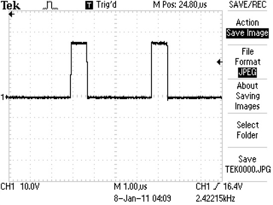

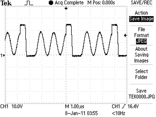

    When I look at the waveform at the gate of Q1, I get a clean looking square wave. When I measure the waveform at the drain of Q1, I get the image below:
    It looks as though a sine wave is superimposed on a square wave, which I did not expect. However, the 9V output is stable when it is not loaded. When I apply a 10K resistive load to the output, it is also stable. However, when I apply the intended load (the cascaded switching regulators) to the 9V output, the voltage drops to an unsteady 3.3V DC on the output, and the waveform I measure at the drain of Q1 is:
    Now, it looks just like the square waveform in the image above, without the sine wave superimposed. The waveform at the gate is a steady 24V DC. There is no switching going on.
    When I disconnect the 9V power supply from the intended load (the cascaded power supplies) and power them from an external 9V supply, the intended load functions properly. There are no shorts in the intended load. I believe there is still something that is not functioning properly with the 9V supply. Could it be a time constant mismatch between C11/R10 and C4/R9?
    Thanks for all of your help so far!

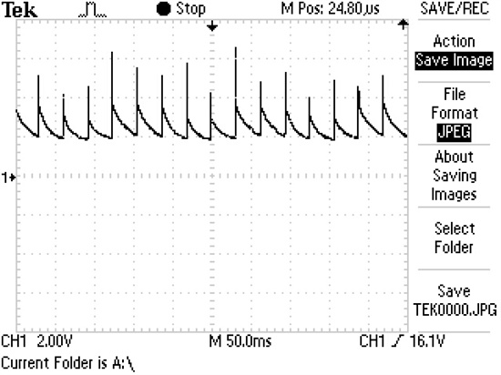

  • To further add to the images, when I zoom out to 50ms/div, this is the waveform of the unsteady 3.3V on the output side of the 9V supply when I hook it to the intended load:
    This noise is not present in the unloaded or 10K-loaded state. There is no noise like this on the intended load side when I hook up an external 9V supply either, so I believe the problem can be attributed to the 9V circuit.
  • Kimberly,
    What you're seeing here is the TPS40200's current limit response.  When the TPS40200 controller detects a current limit event, the converter is disabled, the soft-start capacitor is discharged slowly to 150mV, then the converter is enabled and the soft-start capacitor is charged through a new soft-start cycle.
    When the converter restarts and the ouptut votlage increases again, it triggers over current and shuts down once more.
    What is most likely happening is the LDOs of the intended load are likely all turning on about the same time and drawing a large amount of current from the 9V rail together, and this spike in load current is triggering OCP, forcing the converter to shut-down and restart.
